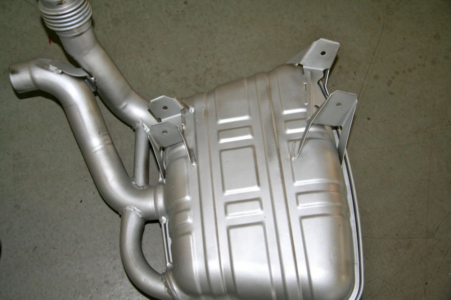

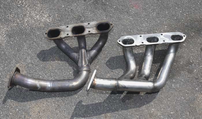

Interestingly while switching in "gundo" mufflers I noted that the C2 actually has X51 like headers, see first picture. For some reason the C2/4S's are being strangled with their headers. X51 might make sense on an S but not on the 3.6 non S motor.
Adding the gundo mod, see second picture, to my std exhaust, makes it operate like a PSE, and has made the world of difference to the sound, listen to the clip.http://www.youtube.com/watch?v=Lb0pc-7VPu0
I also noted, by the seat of my pants, that it seemed to rev easier after the mod. Others have noted this fact too.
You are correct. The stock C2 headers are perfectly fine and are identical in design to the X51 but have smaller diameter tubes. If I recall correclty the stock are 42mm diameter and the X51 are 48mm.
Just curious why someone would spend 2x on other headers instead of the X51s? A piece of pipe if it's the same material, is a piece of pipe in this case right? It's not a muffler, there isn't any "additional" engineering in terms of shape and I can't imagine the size of the opening that Porsche makes on the X51 is somehow too small or something. Anyone have an ideas on this?
Header design is a matter of compromise. Length of the runners, diameter of the tubes, collector styles all alter how the exhaust is scavenged and can change the torque band and peaks. IMO, Porsche knows best and X51 is great for the price. However, if I was considering a complete system that included the mufflers and the CATs, I'd consider staying with the same vendor as they tuned it to work together nicely. Also, the Porsche X51 build quality in terms of bored smooth welds and finish may not be as nice as the more expensive options if you care about such things.

Headers are the start of the exhaust system and are where the gases exit the engine, and are visible as 6 (two groups of three) tubes in the center of the frame.http://en.wikipedia.org/wiki/Catalytic_converter
