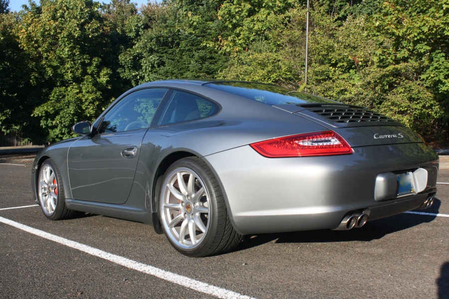

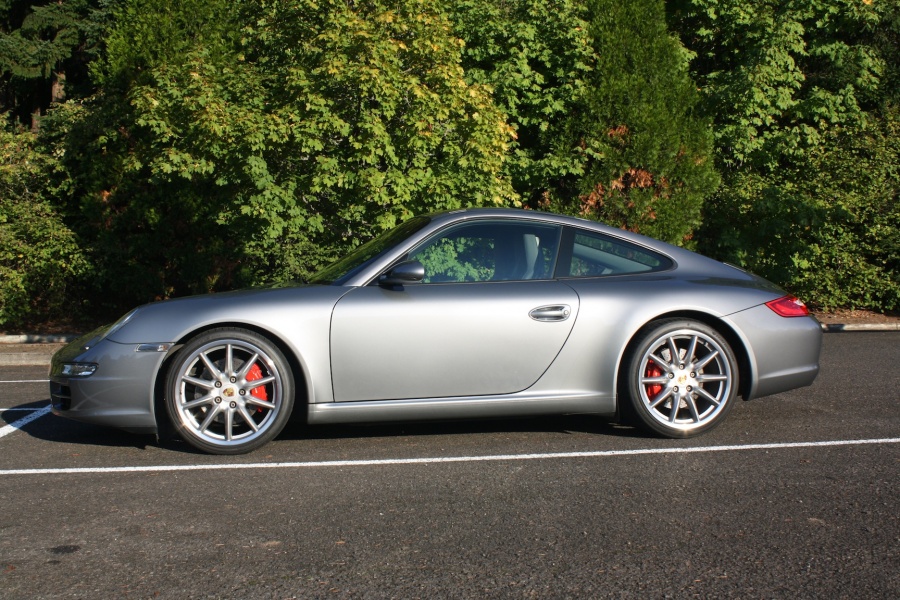

Anybody have a photo of 295 rears on a 11.5 rim?
Trying to decide between two tires. Bridgestone has an all season 970 Pole Position tire but 295 is the widest they go.
Damon at TR cautioned me they may look stretched out. I'd probably prefer a bit of bulge for rim protection.

Hope this works. 295s on 11.5 inch rears.

Thanks - that might even be the same color as my car.
On my 305s it definitely looks like I have a bit more rubber sticking out past the lip of the rim. My car is a daily driver in Chicago with bad roads and lots of potholes.
What tires are those?

Those are Hankook ventus V12s. They only had about 3,000 miles on them when I bought the new wheels so I just switched them over. They seem fine on the 11.5 inch rims. That said, when I need new rubber in the back I plan on going with 305s.
