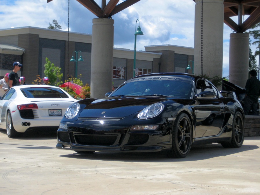

does anyone know how to remove these 997 running lights ,I want to relace them with a different set of LED's .I am trying to avoid removing the front bumper .Thanks any help is really appreciated .see pics
1st pic is my car 2nd is what is going in .Thanks

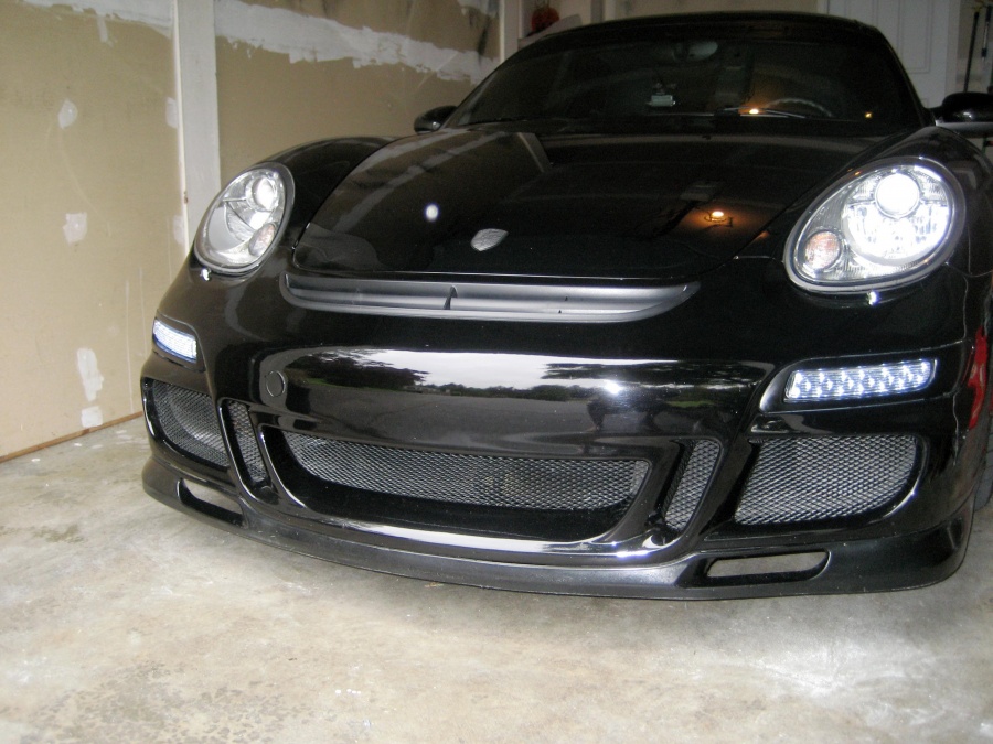

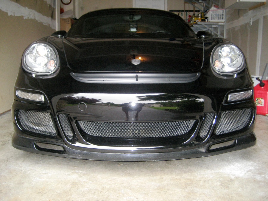

Sucess!!!!
this was easy!!!! a no brainer .well when it finally gets dark here in Wa I will take some night photos .Really happy with the results .great quality and they fit FLUSH to the bumper real nicely
first pic shows the car with the lights off.
will post some nightime pics later

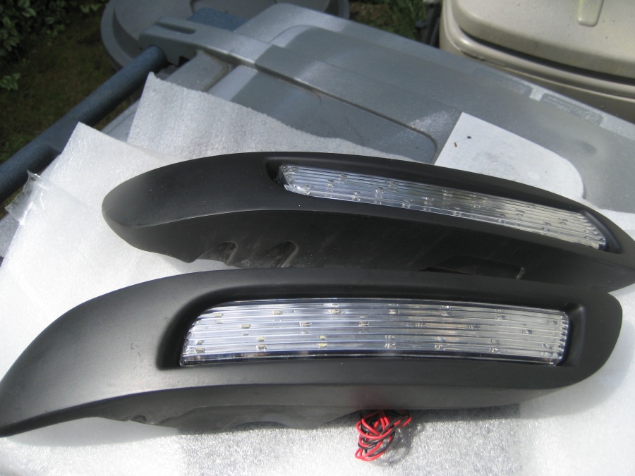

lights went right in no adapter just cut the fog lights wires and hook them up .white colored wire to the red/positive wire and the brown one to negative .piece of cake
the yellow car you guys are looking at is a good example .They send them out in flatt black but i painted my frame piece the color of my car ,I had some factory color paint I bought online .Colormatched
You can paint these frames to colormatch your car and it would look better .IMO the yellow car should have done this but to each is own ,it still looks cool
