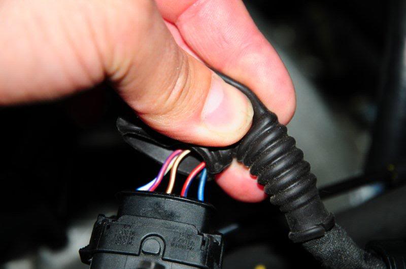

IAT measuring IS a part of the MAF....contact Sean@VF for a fix to that
So imagine the performance gain possibly by measuring a cooler IAT...the computer may keep some timing in it with cooler temps(but I am guessing )
All you have to do is drill and tap a hole in the IC,after it cools the air,and run a temp sensor.
It is the BU/GY wire...
The wire IS the first one on the right........

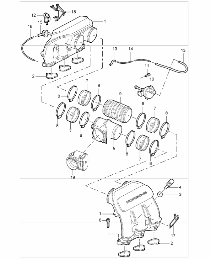

Stacy, are you sure about the MAF also reading IATs?
They are two separate sensors on the turbo...a pair of MAFs, and a boost/IAT sensor on the Y intake pipe.
I was thinking that IATs are measured by #4.

NOT 100% that is where it is measured and #4 may be.......BUT on my wiring diagram that wire says 'Temp. sensor'.???
Now you have me wondering !
Come to think of it.....when I was playing around while doing a supercharger install and was checking some things....I used a heat gun on the MAF from a distance and watched that ambient air temp increase with heat on my Durametric scan program ?!
Stacy

I scanned through the PET part's catalog for the 997 for the word "sensor"...after eliminating all the acceleration, rain, and climate sensors, there weren't many left.
I don't know if I'm much help. I wasn't sure if the MAF read's both air flow and air temperature. It's separate on the 997TT.

#4 in the diagram is the temp sensor for ambient temp in the engine bay, which shouldn't be the same sensor or temp as IAT.
The question now is: where is the IAT sensor located?

I answered it for you in that post and confirmed it today(hopefully two of us can't be wrong,LOL)........the heat gun thing did work.
AND YES the #4 in the diagram that was posted IS the under hood temp sensor that is there for turning the under hood fan on and off....

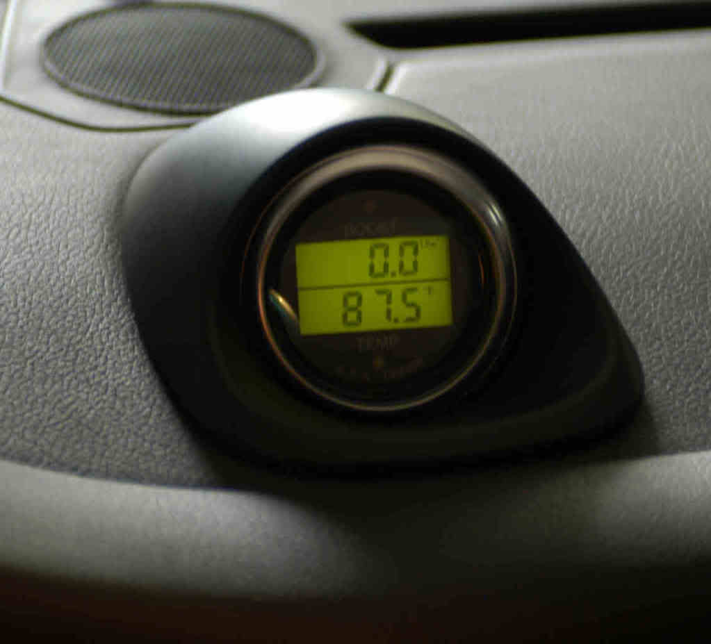

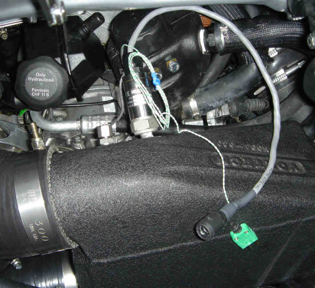

I installed a SPA temp and pressure gauge on my VF-E supercharger. The temps coming out of the supercharger maxed out at 188F during two days of Porsche DE with an OAT of around 75F.
Typically the temps are in the 110-130F range when driving normally and OAT in the mid to high 80'sF.
And how was your car doing during that time taking air heated to 188F?
BTW 'coming out' means before intercooler of after?
Would be interesting to see data from TPC turbo system, from what they posted so far I think their temperature is coming from same MAF before compressor.
