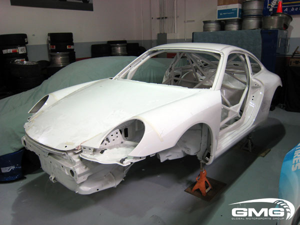

That's quite an evolution but honestly, take it down to a bare tub and build it up instead of building it down.
Almost every real race car build starts this way. Your almost there anyway.
GMG has done it before plenty of times...see pic.

Here is a quick list of stage 1 weight loss for the car.
Gomez weight reduction tallies *estimated
-45 lbs - Muffler delete
-19 lbs - naked trunk
-8 lbs - OZ wheels over lobster forks
-9 lbs - No washer fluid
-20 lbs - remove stock rear deck lid add new carbon wing
-90 lbs - remove stock seats add one evo drivers side
- 65 lbs - remove all interior carpet and foam, back seats and subwoofer
- 25 lbs - replace stock battery with light weight braille battery
- 8 lbs - remove street seat belts
- 19 lbs - LWFW and Sachs Pressure PLate
-10 lbs - cup car front bumper - no reinforcement
-15 lbs - removed glove box and passenger side airbag
-20 lbs - remove rear bumper reinforcement and heat shield
-40 lbs - sunroof delete
- 7 lbs - radio delete
Total - 400 LBS Lost
New car weight 2960 LBS
