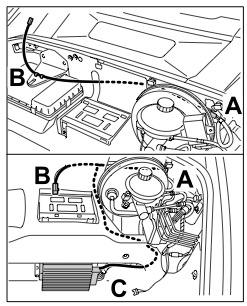

Let me try to answer in sequence you laid out.
A)The first copy of the doc I sent you was in MS Word 2010 format and the second copy of the doc I sent was in Adode PDF format. Others have been able to open doc (with pics) so not sure why you can't see them. I will try to save a copy of the doc in MS Word 2007 format and send it to you. You could also try opening attachments using Google docs if you are familiar. Other than that, sorry but I'm out of options.
B) First note that I opened my original response with "I believe..", simply because I don't have 1st hand experience with a 997.1 without a CDC. (As mine is only car I've worked on. I'm not a P-mechanic just a fellow P-enthusiast with an electronics background.) So I want to set expectations...
Ok, having said that do some search on 6speed & renntech.org forums for CDC installs and you might find pics on where the harness plugs into. Since I already had a CDC my harness simply "taps" off existing CDC leads to form a "Y" adapter.
I believe the connecting point for you will be as seen in this pic. (I'll send you the doc this came from as well.)
C) Those are still my recommendations and have been performing well.
Good luck, in the end you'll enjoy it.

Just completed the Sirius module install myself this weekend and it works great! The instructions were spot on and it was a brilliant idea to use an aftermarket Sirius antenna and save some cash! Also, my car didn't require any dealer programming., I suspect this only needs to done if you don't have a NAV or cd changer- otherwise the loop is activated...
I'd like to also give a BIG thanks to Ryan & Ric at Suncoast for providing the parts , Ryan really went the extra mile and ordered the various wire harness options and sent me photos so I could determine what was needed for my application- thanks guys!
What I learned is the harness ending in .81 may only work if you don't have NAV AND no Changer., I don't have a CD changer, but do have NAV- so the harness mentioned worked great, basically Orange MOST unplugs from NAV and power taps into changer harness that was tucked into the L side of the car.., since I don't have a changer I could've gotten the harness ending in .66., this is the same harness- but doesn't have a "Y" adapter to power a changer., I just taped mine off...
Everything works great, however the placement of my antenna may need to be revisited as I seem to lose the signal when in tree-lined streets (more noticeable vs other cars I've had with satellite radio)., anyone else have this issue or find another place to put the antenna? Also, Tram bought Browning, so if you order from TSS radio, get the Tram for Sirius!

If keeping it under plastic cowl for aesthetic purposes, you need to make sure it's at least above top line of hood. Most just slap the antenna on a metal area at about same level as wiper motor which is not high enough. Instead, there is a pinch weld seam just below windshield which is ideal (it's really far up... just a smidge below top edge of plastic cowl).
Also, moving antenna more towards drivers side of vehicle will help. This way, tree lined street or not, it will be closest to center of roadway in most instances where it'll have the clearest "view" of sky.
Good luck
Good luck
