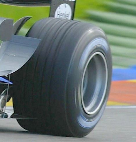

Originally Posted by rye595
Wow - so are all these low profile tires these days on big rims really just for show? I thought the whole point of low profile tires is that you don't want a big sloppy sidewall that flexes?
Have you seen an F1 tire? The tire wall is a major component of the suspension system, its not slop. Allows for higher slip angles (relatively speaking)
dr
