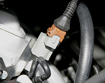

Yes this is correct. And if you're like me and others on this board, you'll want the exhaust on all the time but not the rest. To do this unplug the orange vacuum switch in the engine bay to engage the exhaust full time.

Is that orange plug the same for my 996?
