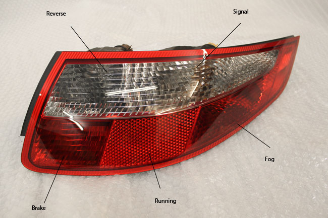

In the old/original tail light, the fog light bulb sits in an area w/a red lens, and at least with daytime running lights, is on all the time on low and blends into the tail light no problem.

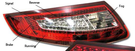

In the new LED retrofit, it sits in a clear lens (and uses the old bulb,...see pic), and since it's on all the time, give the impression of the person reversing (even thought the LED reverse is 100 times brighter)
Well, anyways, this is where it got interesting........he got pulled over by the police since they thought he had a defective tail lights that had the reverse lights on. After explaining to the police what it was and showing him the real reverse lights the cop let him go but told him he'd probably get pulled over again, and gave him a speech about aftermarket parts
After the incident, my friend pulled out the fog bulb and ended getting a error, got frustrated and so now he's put his stock tail lights back in.......
Not sure if there's a fix for this (different color bulb, red film etc...), anyone else experience this or any suggestions. It's made me hesitate putting a set in.

Only the driver's rear is the 'fog', but both rear bulbs that are identified as 'fog' (at least by the diagram provided w/the lights) and they're on on all the time (i checked my car as well)
When you flick your rear fog on, only the driver side becomes really bright, it seems these bulbs however are on all the time, at least at low level

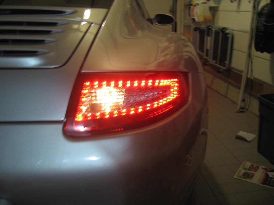

Here's a pic @ lower light, i tried on in my car to see if i got the same result
When i pulled all the bulbs out, these ones (one on each side) is on the minute i turned on my regular headlights (no fog on), only the driver's side one goes brighter w/fogs on
I might have used the wrong term earlier to call these 'fog lights', this was just based on the diagram labels that were provided, and the bulb at least is the fog on the drivers rear side
On a completely separate note it was really easy to swap them out just had to make sure i labeled all my bulbs first. And no error codes on my 2006 C4S.
