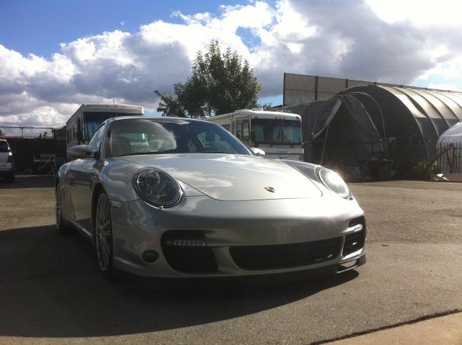

Finally finished up the front Turbo Bumper install! Here's a quick photo from my iPhone when picking it up from the body shop. I thought the stock bumper was low after putting H&R's on... I can barely get into my car now!!! Can't wait to put the rear turbo bumper on!
Looks great and IMO...one of the best ways to modify the car.The best part of this mod IS...that it is a factory Porsche part so the quality is there!
Nice work BBUT do be careful of that front lip as it will touch the ground periodically,LOL!
looks great !
btw, ur car looks like a NB in the pic.. if it is, the rear turbo bumper will not fit as far as i know.

Side note: I didn't end up needing any resistors and didn't get any codes. I bought the Agency LED DRL Lights which have some sort of box attached to it, which apparently has or acts like resistors.
Yes, it's a narrow body and i have yet to try the rear bumper bc this front electrical stuff ended up taking longer than anticipated.
