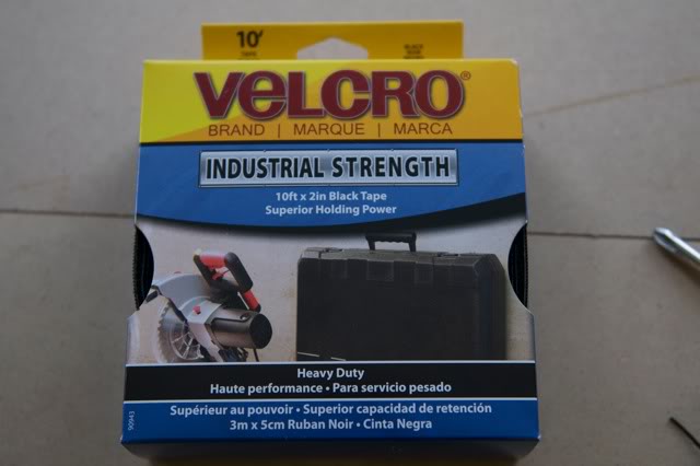

I bought some black velcro to put on the bumper where the cosmetic pieces bond too.....hard to believe that they use this stuff on these cars BUT I have to say it is a GREAT idea.This way there is NO unsightly screws to be seen!
