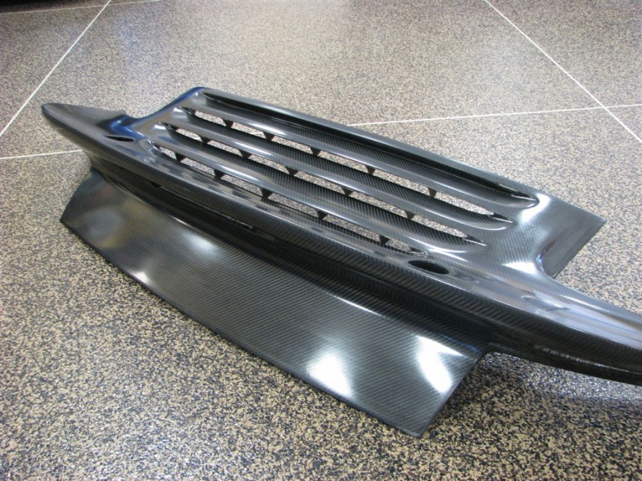

Turbo rear decklid? Meh....
This is what you really want...

[QUOTE=bbywu;3227794]Turbo rear decklid? Meh....
I was offered a TT wing from a good friend of mine...BUT I love the cab without it....or at least for now!
BUT that wing is S-I-C-K....is that yours?
Stacy
