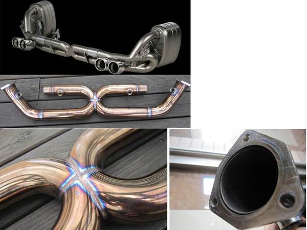

+1 on cat-bypass, it really opens up the sound at top end.
With PSE on loud mode, even the GT3-RS guys think mine sounds great.
Picture of my custom made X-pipe style cat-bypass very simlilar to fabseed and akropovic design

Gundo + Cat-bypass is too loud in my opinion.
Since my car has PSE and in loud mode it is similar to a factory muffler after Gundo hack.
This gives you a sense in terms of volume: PSE (quiet mode) + Cat-bypass = PSE (loud mode) + factory cats
If you are going for high flow cats, you will probably want to do Gundo to have a good aggressive sound.
I would suggest you do the cat-bypass first and then the gundo if you decided to go with cat-bypass.
