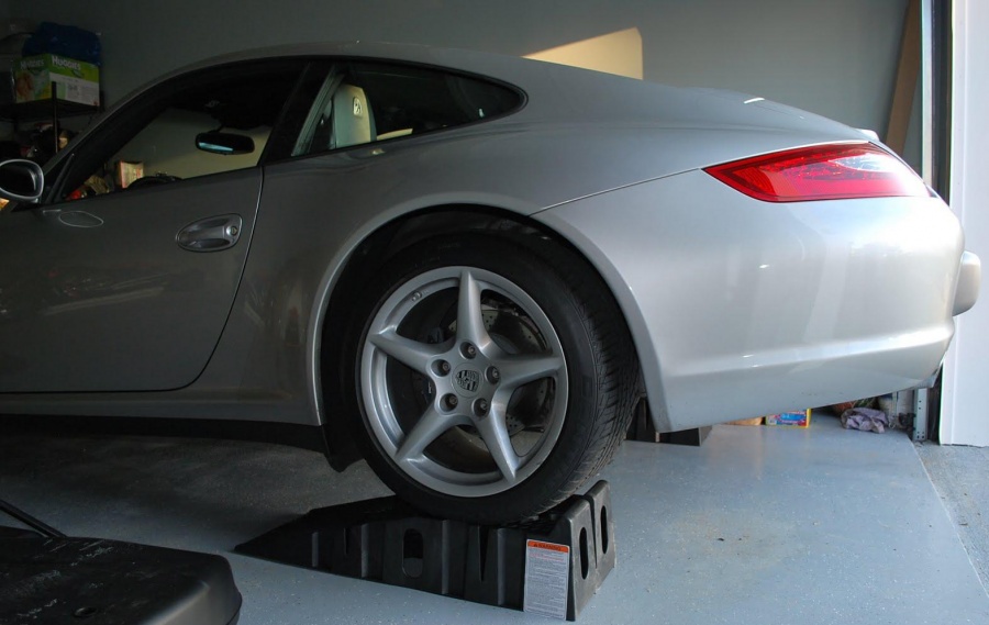

Step 1: Drive up to ramps
Tools Used in this step:
1. Rhino Ramps : $ 59.99 (Got it for $41.39 use coupon RETMENOT123 for $20 off of $50)
2. Rhino wheel Chokes : $ 6.99
Get some jack or ramps for this for better clearance under your car. Picked up rhino ramps in below, they are so strong and solid, good investment for future oil changes.
Drive the car up to Ramps. The front bumper is not touching the floor
Put some chokes for safety. Not needed since i engaged e-brake and put the car in Gear after putting in ramps.

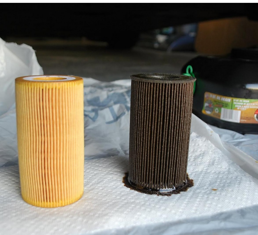

Cover your garage floor for any spillage. Unscrew the drain plug with 8mm hex. Unscrew the oil filter with oil filter wrench
See old Vs New oil Filter

Great pictures! How much oil do you think you got out of the engine? I would think that with the car not being 100% level, that some would be left in the engine sitting just in front of the drain bolt. I'm sure out of the 9 quarts only a small amount was left.
Old Feb 1, 2012 | 02:38 PM
lenelsa's Avatar
Joined: Sep 2010
Posts: 74
From: Los Angeles
lenelsa is infamous around these parts
I would lift the front end as well.
Old Feb 1, 2012 | 02:40 PM
adias's Avatar
Joined: Sep 2004
Posts: 2,363
From: SF Bay Area, CA
Rep Power: 170
adias Is a GOD !adias Is a GOD !adias Is a GOD !adias Is a GOD !adias Is a GOD !adias Is a GOD !adias Is a GOD !adias Is a GOD !adias Is a GOD !adias Is a GOD !adias Is a GOD !
I hope that, after draining the oil, he moved the car off the ramps to drain the remaining amount, which he could do by having someone push it down, while he was inside applying brakes (e-brake at that, as disk brakes are now very hard). This assumes he had a comfortable space in front of the car...

i cant imagine that much is left but in any case, i suggest investing in 2 jacks and some stands so you can put the car up properly.

Consider also cutting apart the used oil filter to look for metal shavings or bits of plastic that might indicate a looming engine problem.
good point. i will do that, nothing found unusual as of now.
Update : Thank god, nothing found unusual.
