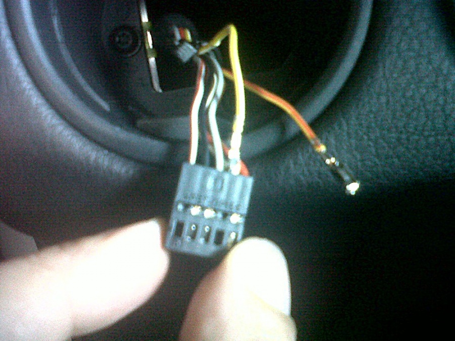

well, folks, i had a couple of hours in between conf calls so i decided to do same thing in a different way. as i really do not care of running low beams together with fog lights and all i wanted was to be able to turn them on easily i decided to try how a simple swap of wires will work.
to be precise - it is a removal of 'home' wire from A2 position and insertion of an A5 'fog' wire into its spot with no taps used at all. A5 spot stays empty and A2 wire will be wrapped in electrical tape and set aside.
this way you eradicate original parasitic drain from fog wire and as long as you keep switch in a 'home' position you should (hopefully) have a 0 drain from a light switch - all light switch does in 'home' position is a direct connection of A2 wire to a ground. so keep it in 'off' when car is left alone for long time.

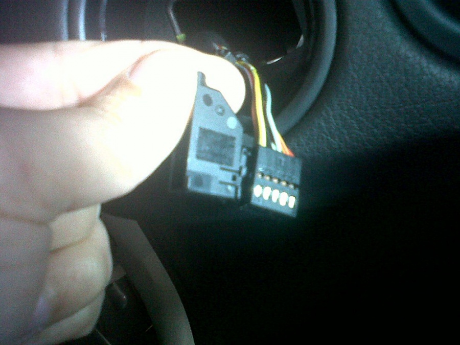

to take switch connector apart you pull little tab on its side and then inner insert slides out.
but this way your light switch will not be able to turn on fogs where it used to be able to do it. also, when car turns on fogs LED lights up as there is no more voltage there supplied on pin A2 but it is a minor side effect imho.
anyway, i will keep it like that for several days, if battery charge level stays the same i`ll post an update.
still, best and most elegant solution would be to put a diod between wires in their original positions but i do not have a spare diod, so, no luck.

Whatever that signifies - after I swap wires yesterday battery level remains at same exact voltage so this way seems to be safe. I'll keep it like this for my car.
If you prefer to retain original fog light function I suggest using a diode to avoid any possibility of a drain current from 'home' wire into 'fog' wire, you only need current to go from fog into ground when 'home' is connected to it in a switch.
