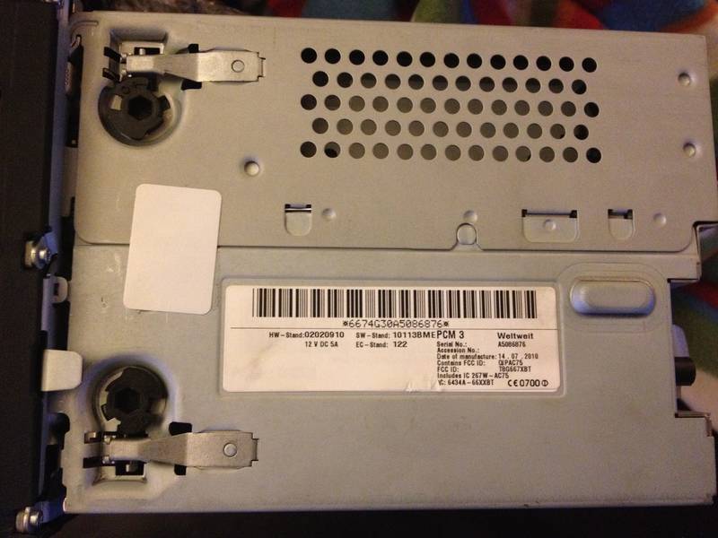

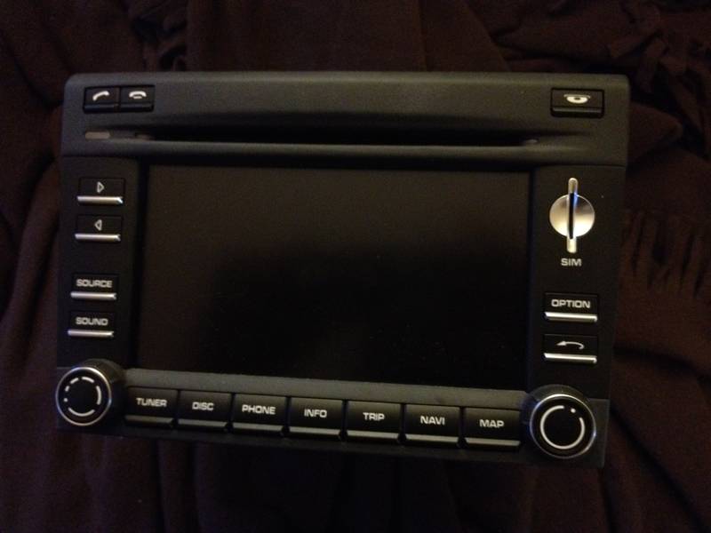

Hey guys so i found a PCM 3.0 unit for just under 1000$ . Item is as new in perfect working order.
Seems super cheap to me.
So my question is ( since i haven't been around these boards in quite a while )
Can swapping out my PCM 2.1 in a 2006 C4S to this unit PCM 3.0 be possible?
Has it been done yet?
Here is the item description with all the info :
NEW 2011 PCM3.0 WAS REMOVED FROM BRAND NEW 2011 997 MODEL
HARD DRIVE NAVIGATION
has 6 disc cd changer inside.
BLUETOOTH READY , XM /SAT READY
THIS UNIT IS USB AND BLUETOOTH
TOUCH
Condition
100% WORKING CONDITION
REMOVED FROM BRAND NEW 2011 997 TURBO LIKE NEW
Factory part number ::
PART# 997.642.170.01
navidaten : 7PP.919.193.R
DVD-LW : 997.642.190.01 = 6cd disc changer
TEL: 6678
DATE : 02.09.2010.
SERIAL :A5086876
Any help would be great!

it is a tricky one. if it has no bose option PCM is actually a fully analog unit from output perspective.
from input perspective it sits on a CAN bus so, it is down to question what ECU you have on a 2011 turbo and if it speaks same language with your car.
imho, it may work. only way to find out is to try it. but, you know, with ebay you never know. i would try to negotiate with a seller ao option for refund if you will not be able to pair it with your car.

if you have Bose - your sound is sent over digital optical cable to your Bose amp. that means new PCM must have Bose module too. standard non-Bose PCM has simply 4 channel analog output with RCA jacks. i cannot tell from pictures what unit it is that guy sells.
Call or visit service manager at dealer first and try to ask him to get his best tech into office to discuss this stuff. they should have some knowledge hopefully of what can and cannot be combined but i would not give much hope there, you know, they never 'try' such stuff as to put units from newer models into older ones and most likely they will not want to do it. a good local installer who works on p-cars and has his own PIWIS station would be better to use, imho.
