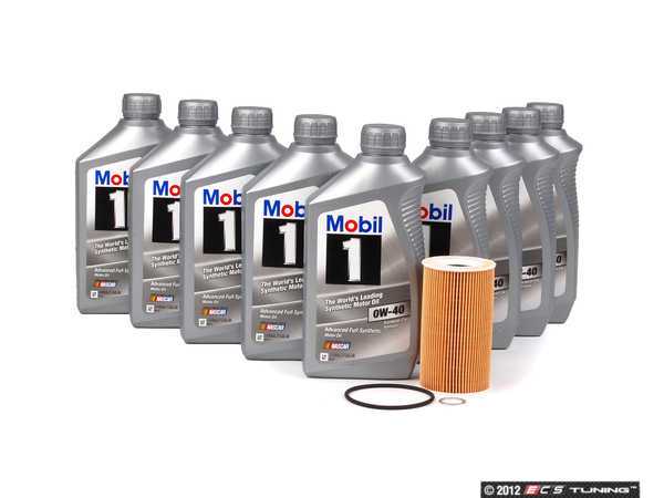

We offer the complete oil change service kit you need to DIY. For more information 997.1 Kit Click Here
For more information on the 997.2 Kit Click Here
  • Nine quarts of Mobil 1 0W-40 Synthetic Oil
  • Factory Oil Filter Element with Correct Rubber O-Ring
  • Drain Plug Crush Washer

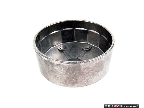

buy an OEM Filter, and you will need a wrench to get the filter housing off. I bought the OEM one, as I don't want to crack the plastic filter housing and have to buy a new one.
As for oil, as long as it is on there approved list, then use it. There are a number of DIY threads for these cars on the internet, and it is easy to do...just time consuming as it takes a while to drain all the oil.

NorthVan You are correct and should always use Genuine Porsche Oil Filter Wrench like the one shown below to avoid failure.
Or a 36 mm socket like the one below if you have a 997.2 with the top mounted filter housing
Amazon Amazon

ECS- question. Are the 997.2 and 997 caps and cap wrenches different? Mine has a 36MM nut (if i remember correctly) on the top of the cap (997.2)... The pic you showed is for a 997.1? My dealer told me to just use the socket right on the top of the cap nut... Look at the pics in my link.
https://www.6speedonline.com/forums/...er-change.html
