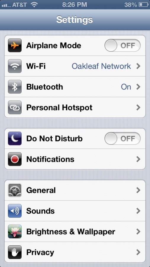

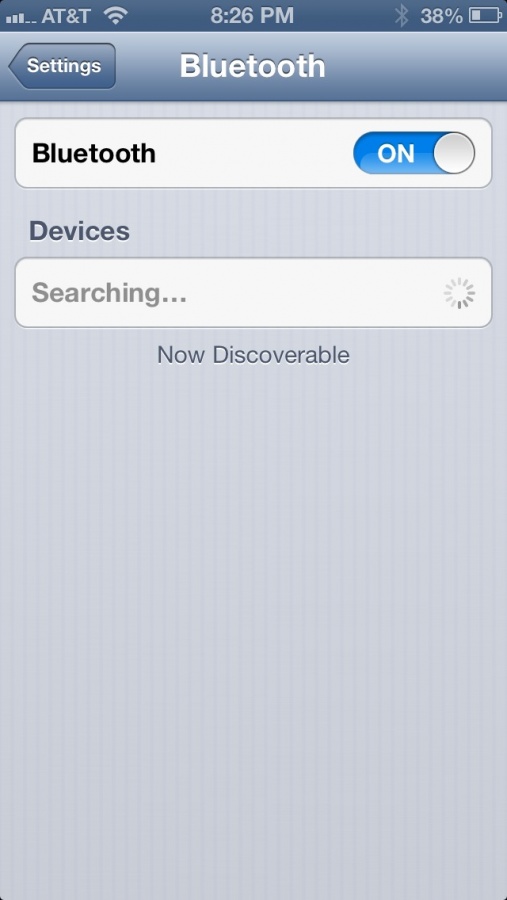

Yes. I have Bluetooth in the car. Initially got the phone paired and it listed my phone on the PCM screen. Here is why I think it's a phone/iOS thing. My little Bluetooth symbol in the top right only stays on while I'm on the Bluetooth page in Settings. As soon as I back out into the main menu (on the phone) the Bluetooth icon disappears. It does this even with personal hot spot turned on. After this happened I couldn't get the phone to repair with the PCM. I may try with my wife's 4 and see if it works with hers.
Old Nov 8, 2012 | 07:27 PM
endo911's Avatar
Joined: Sep 2010
Posts: 59
From: US
endo911 is infamous around these parts
Screen shots attached.
Well, when at the main screens, if bluetooth is on, you should still see the grayed out bluetooth symbol on the screen. If you don't the bluetooth radio on the phone is turned off (or claims to be turned off)... which would be the cause for not pairing.
So solve the iPhone 5 iOS6.01 thing first (did you upgrade to the latest iOS patch?)
