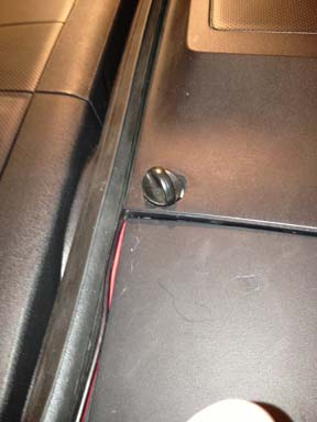

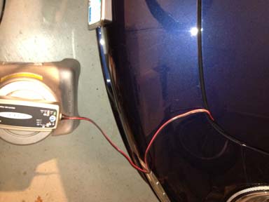

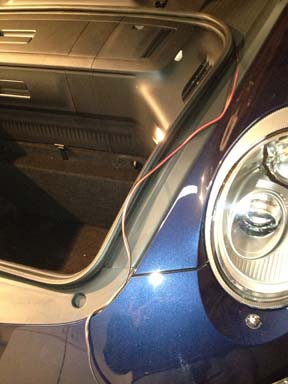

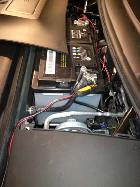

I use a Ctek which is like Porsche's maintainer. The wires are run down the side of the Frunk. There is no interference any where and the wire fits easily out the front even with lid closed tight. Been doing it this way for over 12 years. First on my 996 and now on my 997. I don't know if 991 Frunk space looks the same. I hope pics show up OK.

Well I see no notch in my door. But even if there is I don't want anything on the side of my car because or other car on one side and need to get my Pugsley down on other side. Also floor on sides of car usually wet with melted snow from 4runner. In Minnesota winter is a constant mess. So in front of car is dry and I don't have to worry about someone getting tangled in wires. So I'm sticking with my method.
