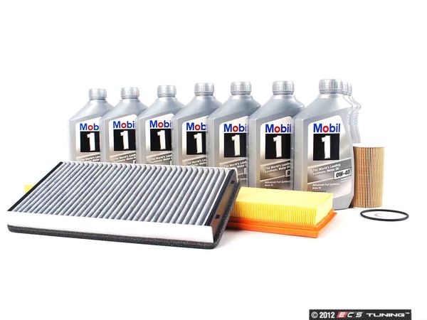

ECS Tuning - Porsche's Avatar
Joined: Mar 2012
Posts: 9,607
From: Wadsworth, OH
We offer a Major Maintenance Kit that includes everything you need. The water pumps still use the harden plastic impellers. Additional items you may want to address if the previous owner hasn't done so is the Spark plugs (every 4 years), Serpentine Belt (every 6 years), and a Brake Fluid Flush (every 2 years).
