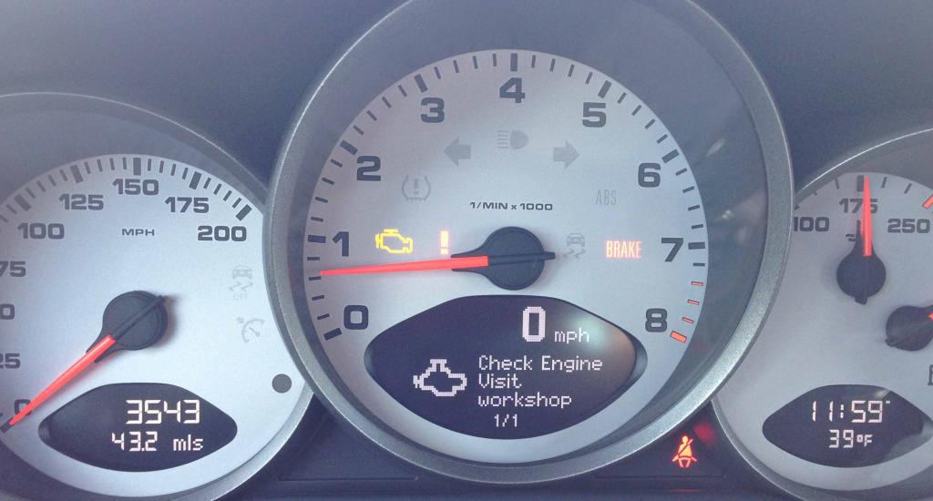

2012 C4S 3500 miles (Standard Transmission)
Cylinder #6 Misfire. Car shudders (like its gonna stall) on acceleration, much worse at lower RPMs less noticeable @ >5000
Has anyone had any issues?
Dealer initially thought it was a gas quality issue. I've only ever filled with 93 octane (7 11 gas...).
Any help/direction would be appreciated.
Brian
