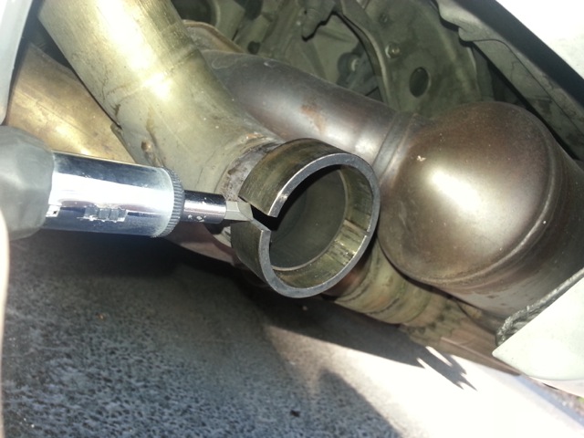

Just swapped mine out this morning: thanks to Keninirvine for the tips and Joel Pirela for the adapter.
Very easy swap:
1. Loosen bolts on old tips and pull old tips out.
2. Slide FVD adapter over exhaust pipes (very tight fit. I used a screwdriver to open up the adapters to slide them over).
3. Slide new tips over adapters. (short side goes towards center of car).
4. Tighten bolts.
