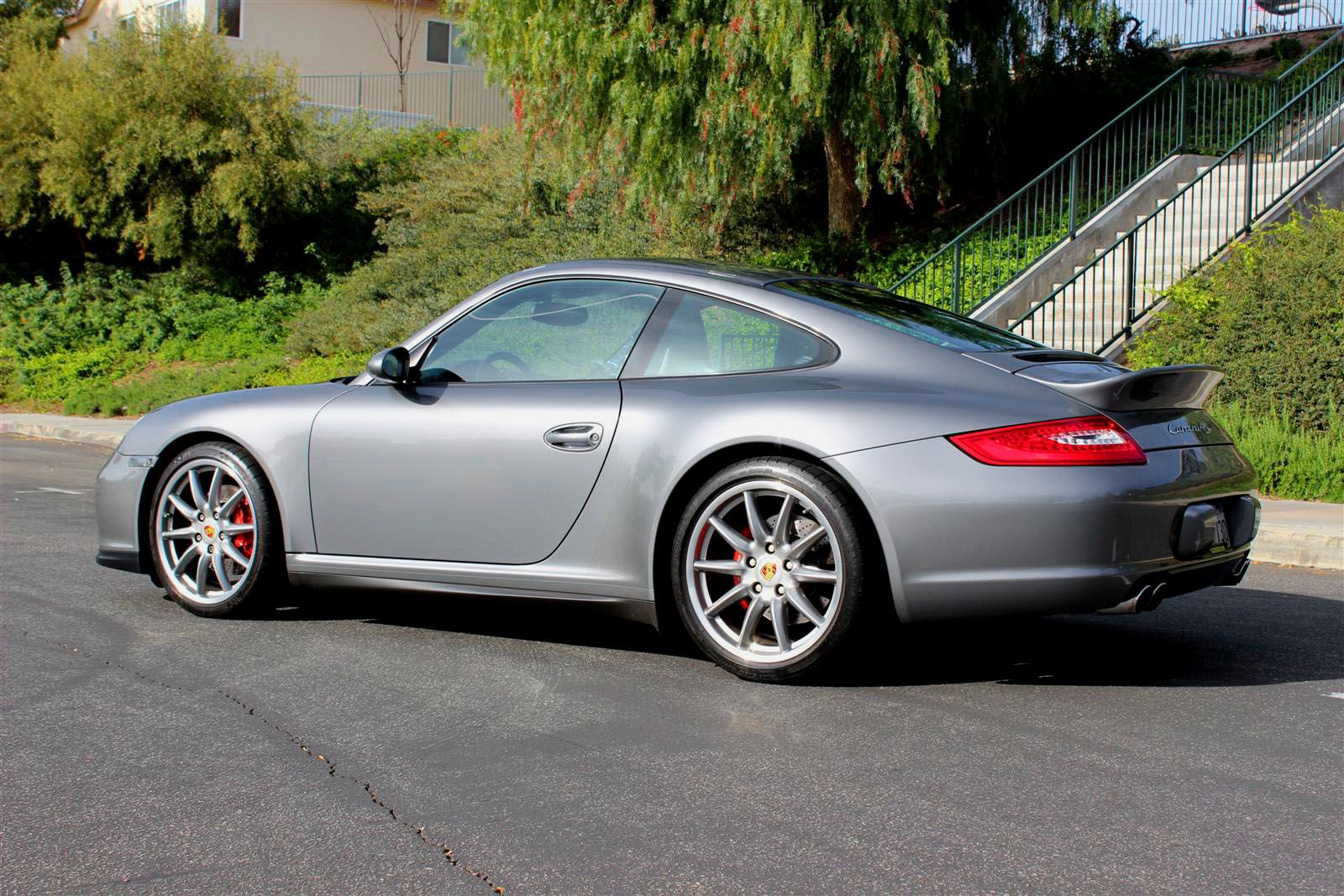

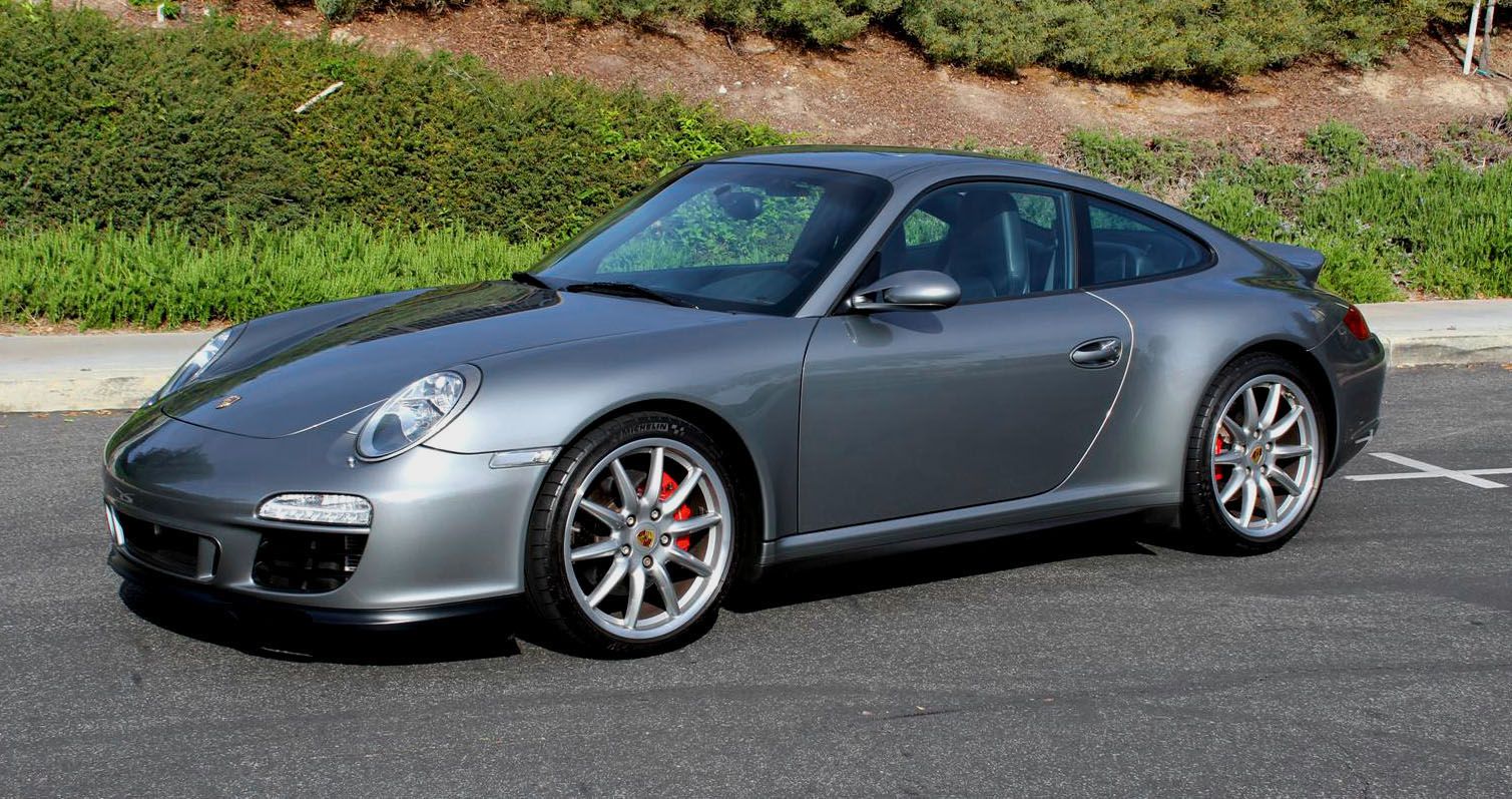

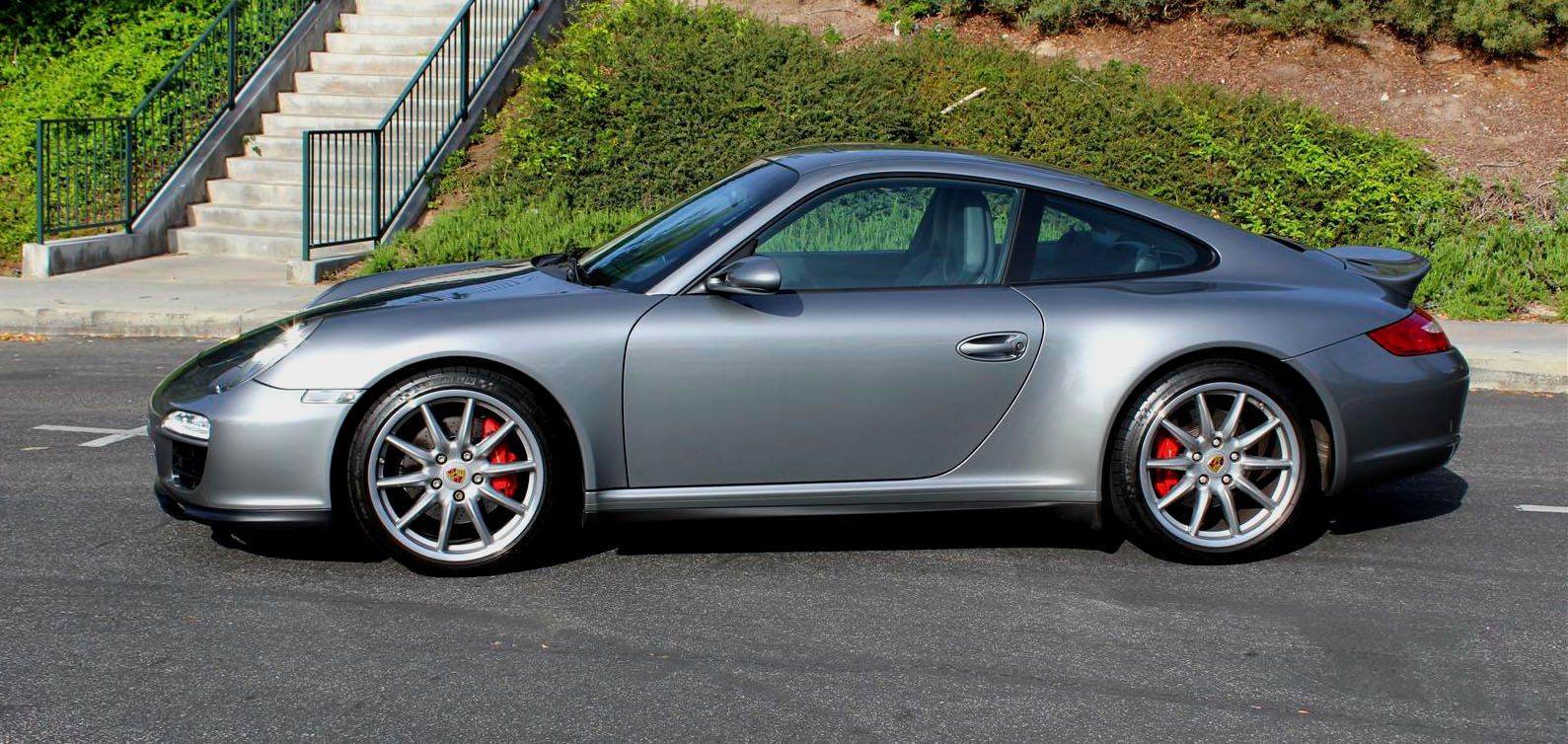

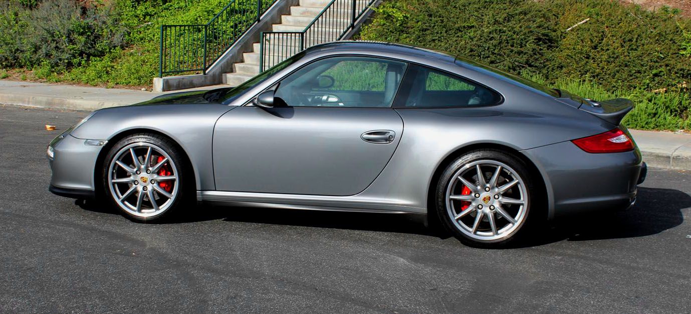

Recently updated my old Misha Duck tail with the newer more raked/steeper angle Misha version. Love this look much better. Also a fitment note/tip for every one who has a Misha duck tail.. Since the Misha tail fits "on top" of decklid it can look a bit high and not flush with the transition from the 3rd brake light to the deck lid. I removed the 4 screws that hold the decklid to its brackets, remove the decklid (remove fan 1st) Then make the bracket holes larger where the screws go in to give you more wiggle and adjustment room ( I used a round file to make the holes bigger) ... I had to widen the holes in the direction of the back of the car and down a few milimeters. With proper adjustment you can have the duck tail with a nice, flush and smooth transition.. It will look like a factory fitment and not after market.. I am really happy with the look of this tail with proper fitment.

looks amazing (as always). now im going to have to compare duct ail differences with your old spoiler
anymore closeup photos of the wing?

Can you post some close ups so we can see what you mean about the figment?
