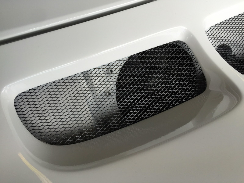

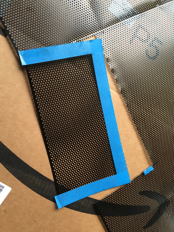

Do you happen to have a link to this mesh ? I couldn't find it

The Misha design is pretty ingenious in that it is a very streamlined design; replacing just the wing and not the entire trunk & uses factory vent scoops. I chose the Getty b/c it's true to OEM and the proportions are spot on in terms of curvature, angle, thickness- that's what she said, haha.
The Misha looks thinner, sits closer to horizontal and further back. I guess it looks more like the OEM 991 style ducktail in that respect.
One last detail…if you go with Getty, the vent insert included is the typical mesh/ chicken wire you can get from Home Depot and it's spray painted black & chips easily. I ended up sourcing a nice sheet of mesh from Amazon and it is anodized black and looks the sort of mesh design that would have come from the factory. Here's the difference:
BEFORE:
Attachment 492548
AFTER:
Attachment 492549
