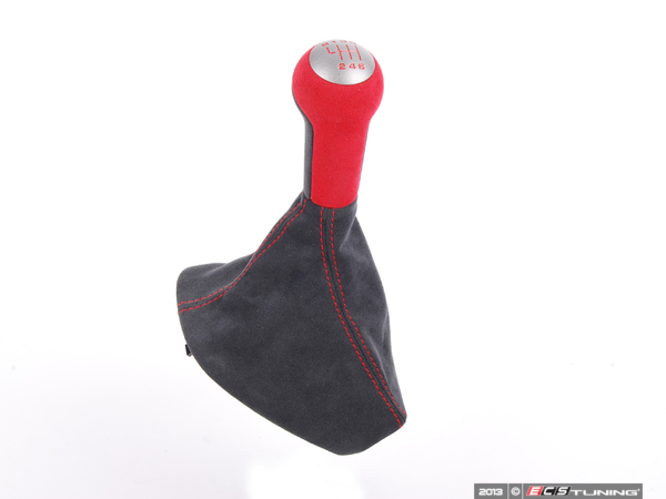

do you have a picture of this ****: http://www.ecstuning.com/Porsche-200...***/ES1499786/
is this oem?
is this oem?
thanks for the links superadjuster, also, sick ride you got there!
Unfortunately we don't at this time but, it is OEM and all leather with a silver (aluminum-look) cap where the shift pattern is.
