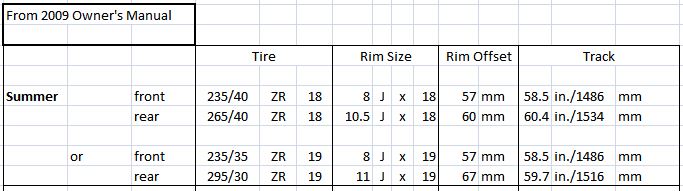

Bruce in Philly is a glorious beacon of lightBruce in Philly is a glorious beacon of lightBruce in Philly is a glorious beacon of lightBruce in Philly is a glorious beacon of lightBruce in Philly is a glorious beacon of lightBruce in Philly is a glorious beacon of light
I guess I don't understand offset
I think I got my math wrong... here is the real data.
Peace
Bruce in Philly

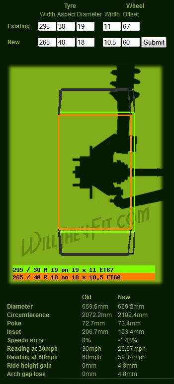

What 18" 19" wheel alternatives look like.....
I snipped this from http://www.willtheyfit.com/ where I entered 19" and 18" data. Interesting. It looks like an observer will not be able to tell the difference between 18" and 19" versions by looking at how the wheels look on the car. They can tell of course by how "thick" the tire is, but when it comes to filling the wheel well..... well it should look the same with most of the difference being between the wheel and the strut.
Peace
Bruce in Philly

Old Jul 2, 2013 | 11:04 AM
Bruce in Philly's Avatar
Joined: Mar 2013
Posts: 145
From: Philadelphia
I think WillTheyFit is wrong
A friend of mine calculated that the 19" will "stick out" about 7mm more than the 18"s while WillTheyFit denotes the "Poke" difference is less than 1mm.
This is due to the increased offset and 1/2 if the increased tire width (the other half is inside).
Any comments on this? This is important because if true, then I need a spacer to keep the same aggressive look of the S.
