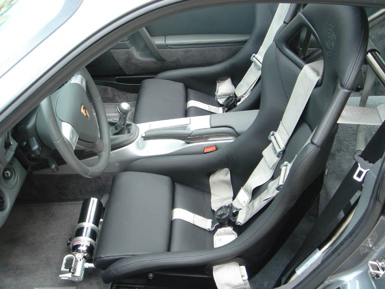

Int. shot.

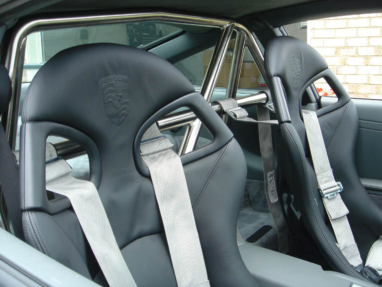

Int. shot 2

Hey dude, how did ya figgure that one out!?
That looks like a roll hoop I had once, or twice.!

rear seat back removal
Hi VB997,
First ,I want to say your car is amazing...
Second, I'm wondering how did you remove the rear seat back?
Does it require some special tools?
Thanks,
Colonel
05 997S Artic Silver

Originally posted by VB997
Int. shot.
I love your car!
How did you get rid of the rear seat belts?

Are those factory harnesses or aftermarket? considering grey belt option on a blk interior for a 4S cab but no pics from PAG anywhere!!
