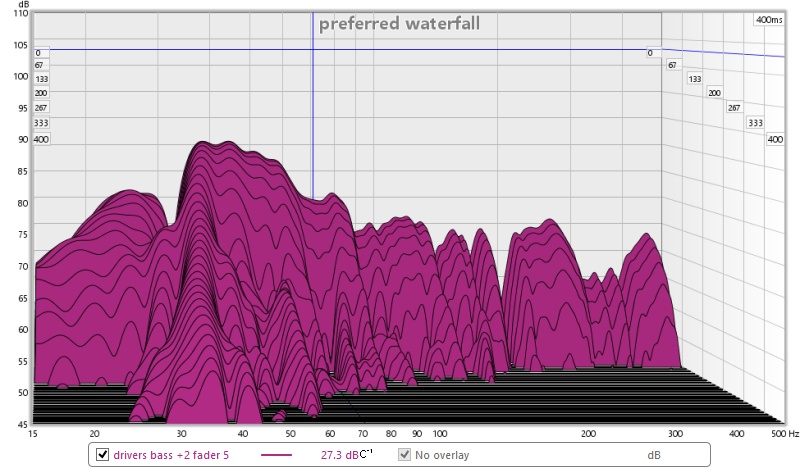

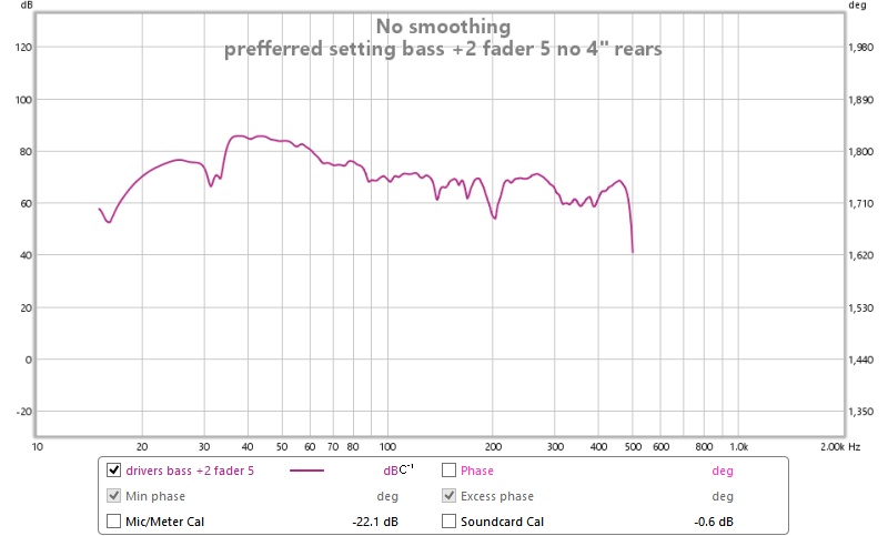

Frequency response measurements
I had a long drive last night where I played with settings. I settled on these settings.
SETUP
997.2 Bose amp, 8" + 4" focals in doors, focal tweeters dash, dayton subs, no 4" rears
PCM SETTINGS
bass +2 fader +5
Measured to 500 hz. These are some excellent measurements and match my preferences for a bass enhanced house curve. It shows good extension down to 35, which is great and more than I expected. Confirmed by my test tracks to deliver! A little boomy on decay down low, but the car cabin is a challenging environment.
