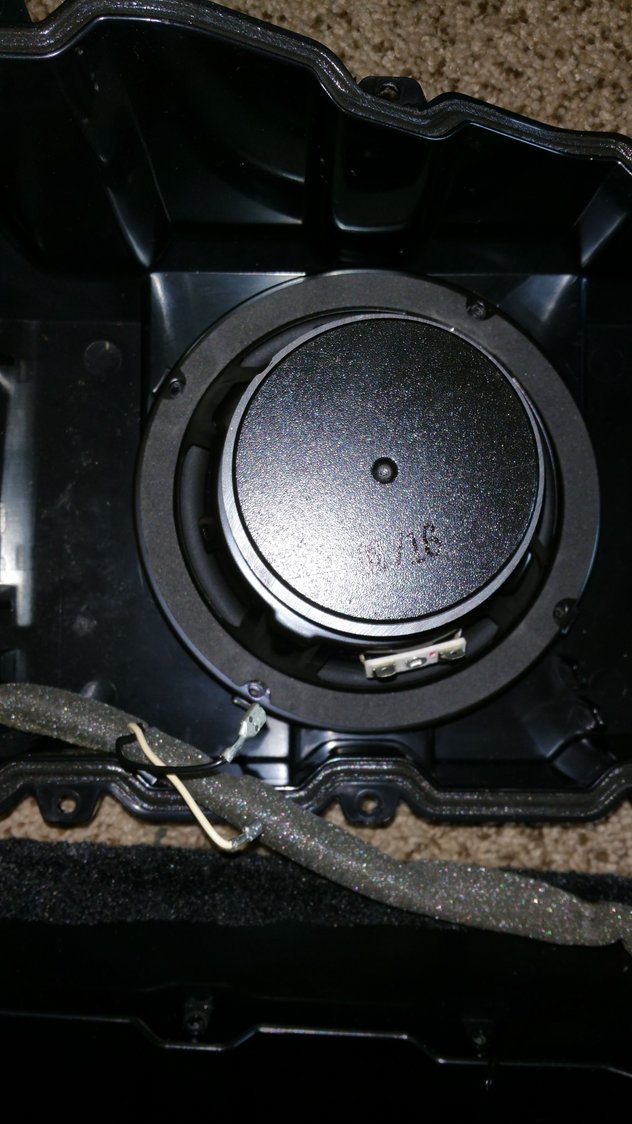

Hello, first post here. I found this thread from the 997 forum on rennlist and decided to replace the subs on my 997.1.
I ordered the Dayton 5 1/4 recommended in this thread from the link below:
Amazon.com: Dayton Audio DC130B-4 5-1/4" Classic Woofer Speaker: Electronics Amazon.com: Dayton Audio DC130B-4 5-1/4" Classic Woofer Speaker: Electronics
The sub box is torn apart with no issues. My problem is the Dayton's have a different mounting pattern and I thought these were a direct swap. The center to center on the Bose sub's are 5.5". The Dayton's measure 5.25" which matches the spec sheet. No one else here seemed to have issues. Am I missing something? Thanks in advance for the help!
Sorry you seem to be having issues. Don't worry about those measurements so much, they are not consistent. Check my pics, did you get the same speakers? The hole pattern is nearly identical, although not perfect. Take out the stock drivers and check out the Daytons and see if they work.

Thanks for the quick response. My speakers have a black label but otherwise look the same.
The hole pattern is 0.25" bigger on the Bose. I took some crappy pictures.

Although the holes did not like up perfectly, I found that you could still use the existing screws into the existing holes with fine results. The difference did not warrant new holes. Also the hole pattern was identical and many other speakers to not use a four hole pattern.

Thanks a bunch for trying to help and I think I understand now. I started threading the screws and they were so angled I was afraid to tighten them.
I'm going to open up the holes a little on the speakers because it will make me feel better and give it another go.

Not sure i would try to enlarge the holes as then you might not get any traction for the screws. They should go in just fine and the stock speakers can go back in and still be secured well with the original screws. (I've done it before).

I was going to open up the holes on the driver's. I'm definitely not touching the sub box. Thanks for the response.
