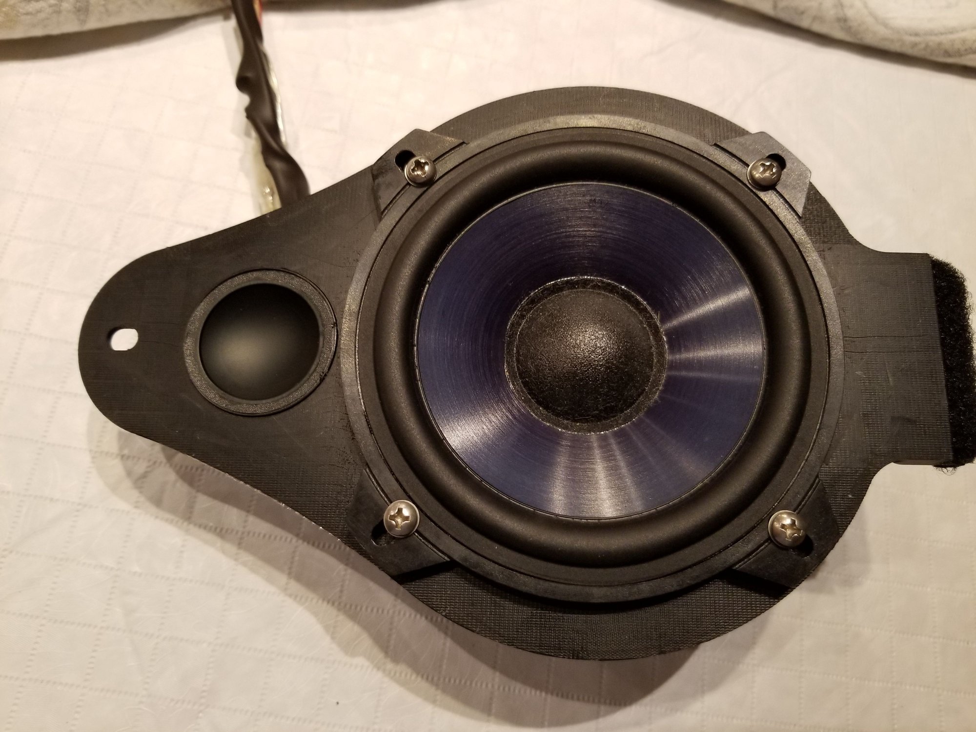

Update to budget audio install
Installed using the same factory setup
Assembled to my new bracket. I used tie wraps for the bundle.
I want to thank Conrad for creating this amazing thread. I want to help this thread with some updates from my install. To start I want to note that I'm very fastidious about my car stuff. With that said, here some photos of my install. I made some changes to Conrad's (ryem3) setup.
First I chose to use the Isn 100 as my front mid and tweeter and only used the 8" woofer from the ISS200 set for the front stage . The rear uses the tweeters from the ISS200 in conjunction with a set of A/D/S 234is. I had these stashed away for a few too many years. Lol. Anyone who is a long time audiophile will know who A/D/S were.

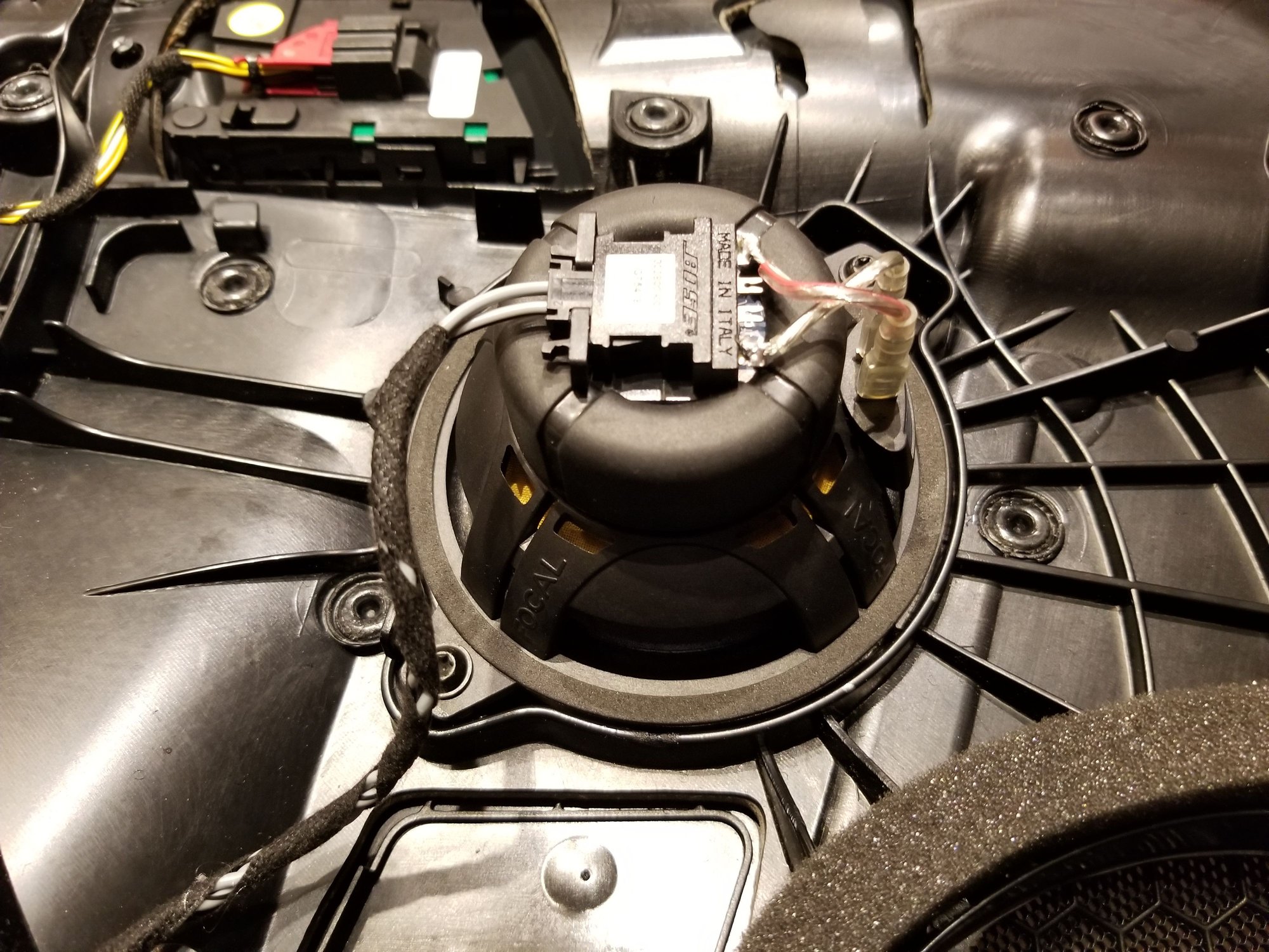

I'll add the photos of my front door mids and rear install. The rears are setup as factory separates. I designed and 3D printed my own brackets that utilize the OEM attachments. I also cut up all the 3" bose midrange speakers to strip the connectors. This becomes all plug and play and no cutting the factory harness.

Used Bose plate rather than using MDF
Purchased an extra set of used tweeters and dremeled the connector. This makes the tweeter plug and play

the red/brown cable, with a "C" tag on it, what's it for? Does it feed into the airbag unit, or is it the tweeter channel?
A pic is worth a thousand words. Without a pic, an airbag wire is very distinctive and the plug has a serious lock at the connection with the airbag.
