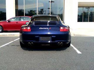

Hey guys,
I am thinking of lowering my 911 C2S with H&R Sport Springs. Before I do so, I have some questions that I think you all will be able to help answer.
In the past I have lowered cars with H&R's and therefore trust their quality. One thing that I do NOT like are some of the things that lowering a car (specifically a BMW M3 with oversized wheels for example) are that the car tends to rub, scrape and tires no longer wear as evenly.
With my Porsche, I am told it is already a bit lower due to the fact that it has PASM. What I am looking to accomplish is a lower stance and therefore a better look to compliment my current and upcoming custom wheels.
What I do NOT want is rubbing or uneven tire tread wear....
So I JUST got done meeting up with a friend who is a Technician for Porsche and needs some side work because business is slow for him this time of the year as it is very seasonal here. He agreed to install my springs for only $250 cash. The springs themselves cost about 300 and he is even willing to do an alignment for free. . .
I pretty much cannot pass this up even though I can live without the car being lowered. The total out of pocket to have my Porsche lowered with H&R's and a fresh high speed balance and alignment for $550 total? Sign me up right??
Do you guys have any input as to what the ride quality will feel like? I absolutely love the way my Porsche feels right now and I hardly ever drive it with the suspension in Sport. I often drive with the car in Sport mode but keep the dampening on comfort because I mainly drive on flat and straight roads with no fun aspect (damn Florida )...
What I am afraid of is that I wont like the way the car rides. I know that the roads here are so nice that I wont really have to worry about bumps or scraping my front bumper believe it or not.. I also know that he will be able to do a nice flat alignment so that my camber keeps my tires wearing evenly. It's just the ride I am worried about at this point.
Thanks everyone for reading this long post and PLEASE feel free to chime in with any input you may have!
