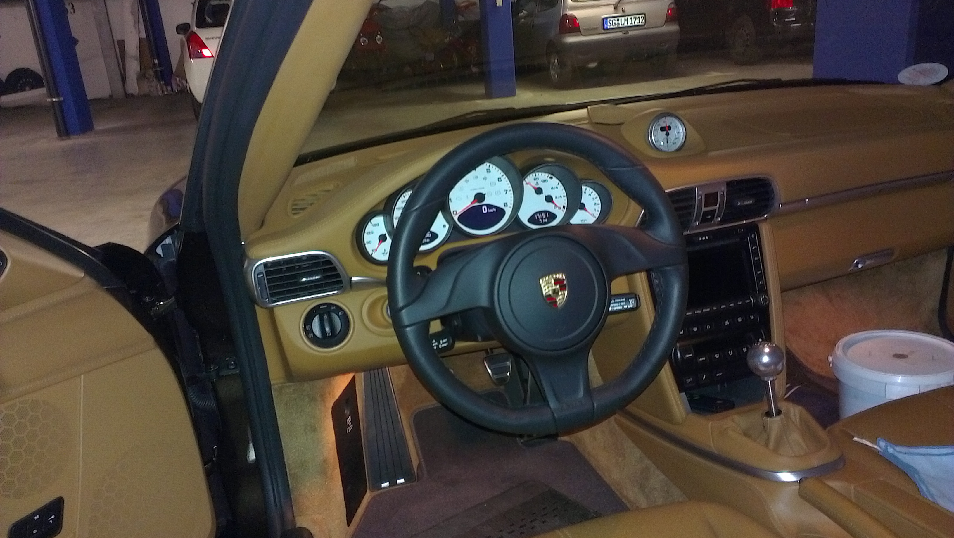

I have a ssk from gemballa, uses a different shift **** that goes with the kit, I like the look and it feels perfect to me, though I have no experience with the other ssk's, mine is also stiff when cold but I am sure that is just the trans oil needs warming to smooth out shifting...

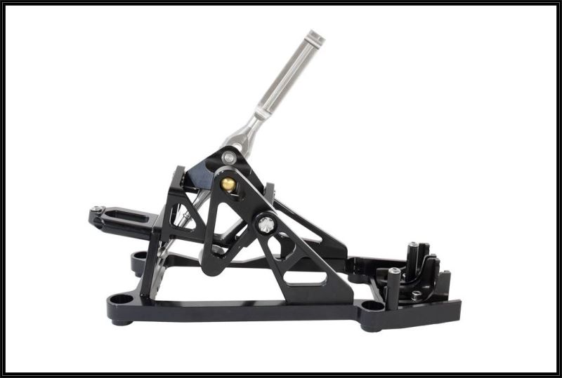

The Numeric is a thing of beauty, damned-near a work of art (and priced for it, too). The B&M is a great shifter, but isn't a complete assembly like the Numberic is. The Porsche plastic part I'd list as a step down from those two.
