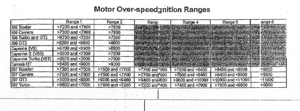

Here is a copy of the range values for various DME Porsches. Range 5 goes up to 9500 rpm.
Three (3) ignitions are equal to one crankhaft revolution.
