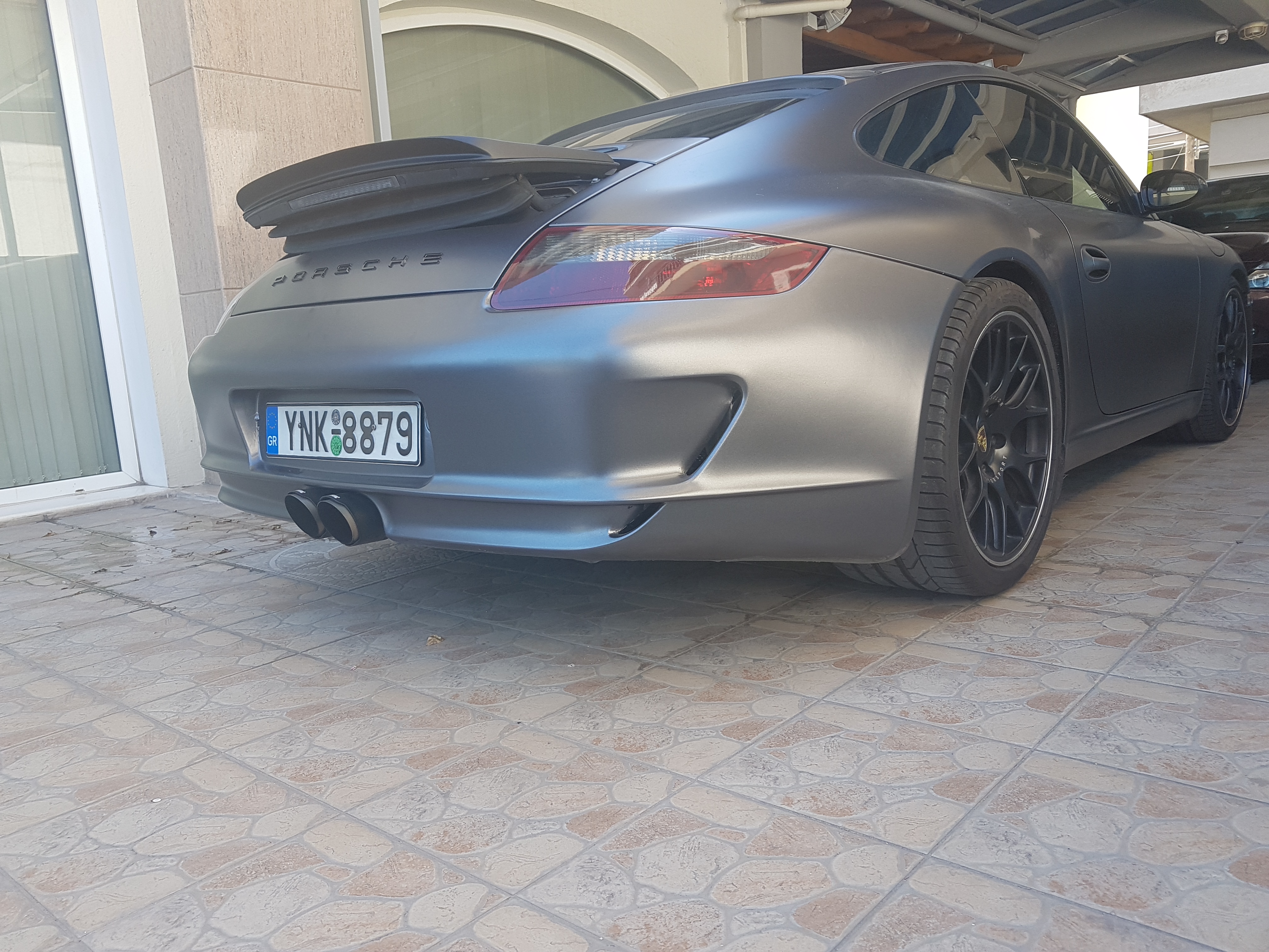

That's my project

Originally Posted by Nikolaos Fyntas
That's my project
Is this rear wing the gt3tek wing? If so how does it look with the rear deck retracted? I have both the rear spoiler and front spoiler from gt3tek as I think you do but have yet to install any of it because I opted for the factory aerokit front bumper. Still wondering if I should install the rear spoiler or not. Post a pic retracted if you have one please.
