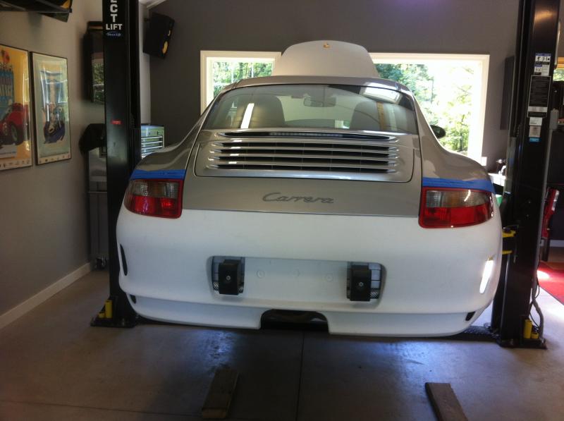

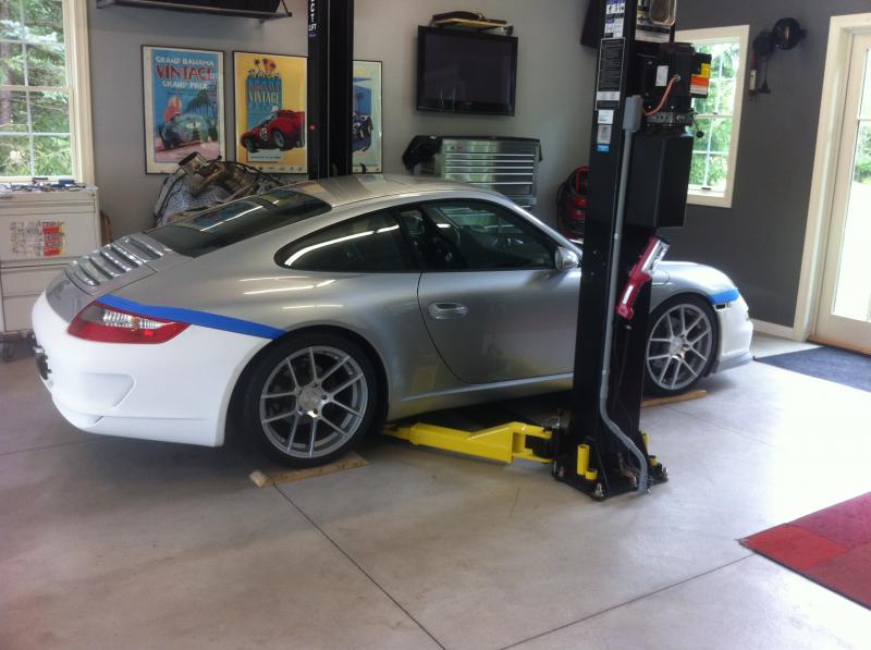

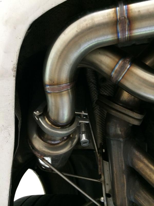

So Fitment on the bumper was great, but there are a few things that needed some adjustment.
First off the heat shields under the bumper cover, and the brackets that hold them on, won't fit under the GT3 Bumpers because of the "vents" in the side of the bumper.
I don't have any pictures of what I cut up, but you can make it work.
The other part about mounting the bumper that doesn't fit 100% is the bottom mounts at the wheel arch. The GT3 one is about an inch lower. Not big deal.

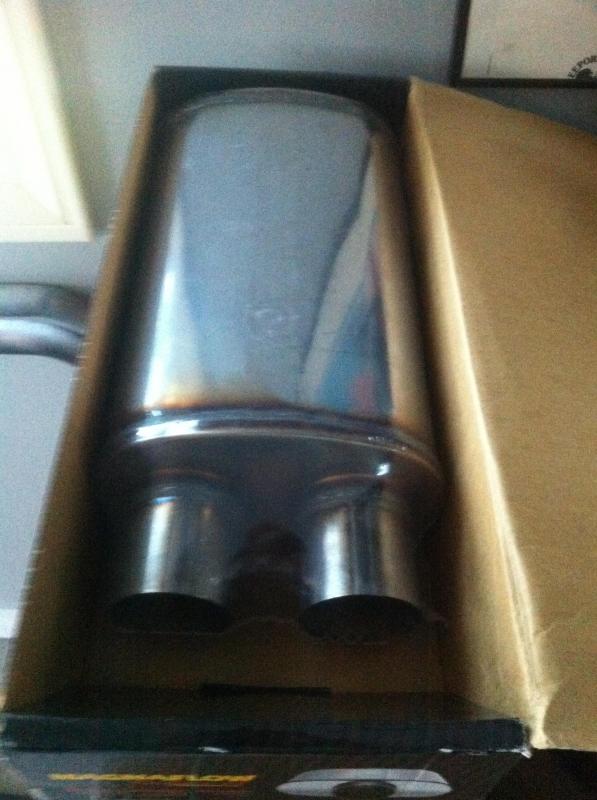

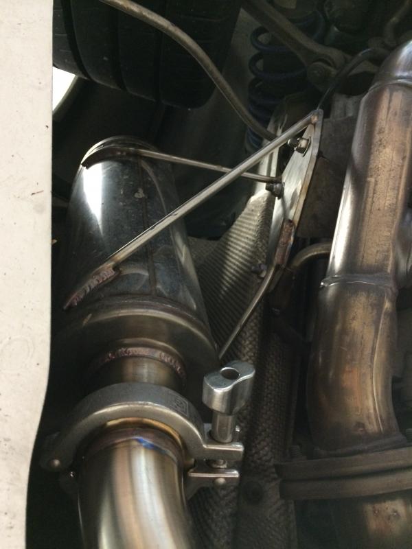

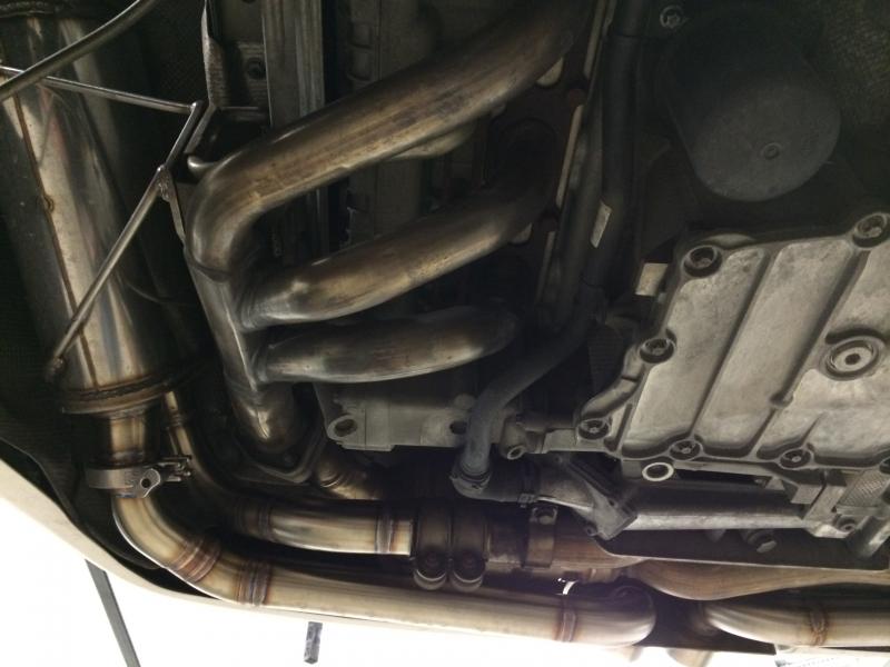

Now on to the "big" issue... the exhaust. I wanted the Center exit exhaust, but obviously that isn't easy. After checking with others and what they did, I decided to try and keep the stock cats, instead of dealing with a light on the dash, or how to eliminate that. It seemed like others have tried, but none with an "easy" fix. Plus I am in NY state and get OBDII scanned for inspections.
I have a local guy that does pretty damn good exhaust work, so I thought I'd see what he could come up with. I bought some Magnaflow mufflers that have the "in" and "out" on the same side.
Here is the 90% done result... (just need to finalize the tips)
Sorry about the carp phone pictures. I know it's not easy to see everything, but you kinda get the idea. It's run similar to the OEM ones, but the piping keeps going past the "side" exits and goes to the center and out.
That's all I have for now, off to paint with it, and then put it all back together and put the final touches on the exhaust tips and it's respective heat shield.

Great looking install. I'd say your exhaust guy knows his way around a TIG torch. Looking forward to the final product.
