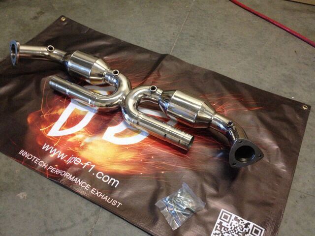

AZPete's Avatar
Joined: Aug 2013
Posts: 124
From: Paradise Valley Arizona
AZPete is infamous around these parts
Mine is made by IPE.
Old Nov 29, 2013 | 05:29 PM
Verde's Avatar
Joined: Aug 2008
Posts: 1,574
From: CA Bay Area, US
Rep Power: 100
Verde has a reputation beyond reputeVerde has a reputation beyond reputeVerde has a reputation beyond reputeVerde has a reputation beyond reputeVerde has a reputation beyond reputeVerde has a reputation beyond reputeVerde has a reputation beyond reputeVerde has a reputation beyond reputeVerde has a reputation beyond reputeVerde has a reputation beyond reputeVerde has a reputation beyond repute
I found that removing the rear bumper made the job a lot easier and ensured that I could properly access all of the fittings and fitments so I could be certain of a proper fit. And removing the rear bumper is pretty trivial.
I'd recommend you go that route.
