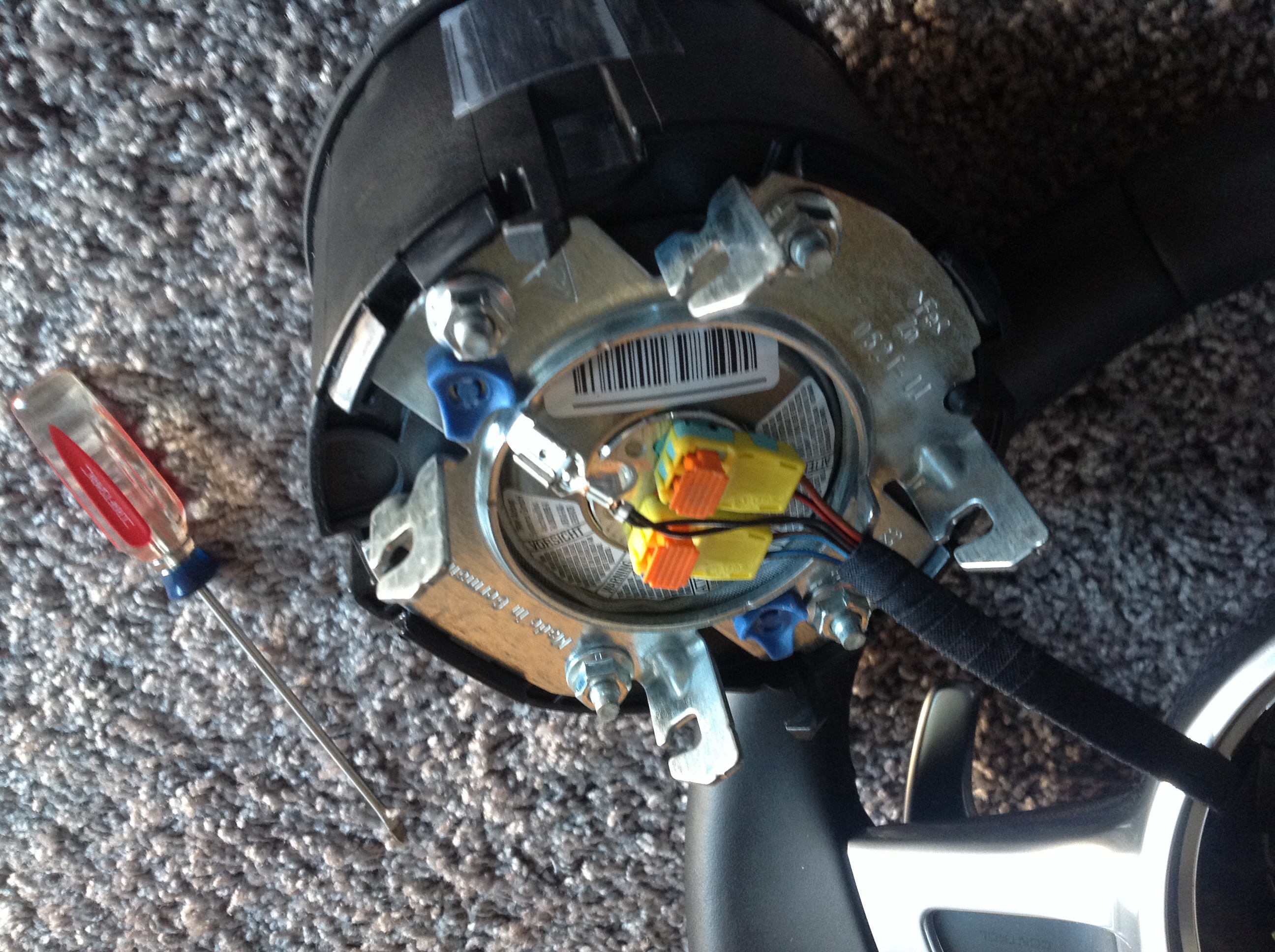

Wire removal
Guys.
After getting the steering wheel off, I had to figure out how to remove the wires from the airbag. Last thing I wanted to do was mess up something electrical.
The black ground wire is easy, slides right off.
The other 2 I had to figure out. Hopefully the picture will show it, but the orange piece slides up. I used a small regular screwdriver. Once that is unlocked, the harness easily comes out of the airbag.
Thanks to all that aided me in this endeavor.
Cheers,
NAV

the longest part of my DIY paddle shifter wheel install was figuring out how to get those wire connecters off... the entire DIY, took 20 minutes and I never did anything like that before. go ahead an DIY this. its easy.

one tip... push the airbag in slightly (like you're pressing the horn) when you are trying to release it. It should help

This should not be too difficult. If you are worried about this DIY because you think the Airbag can pop, don't worry. If the battery is unplugged there is no way the airbag can deploy. It needs electrical current.
