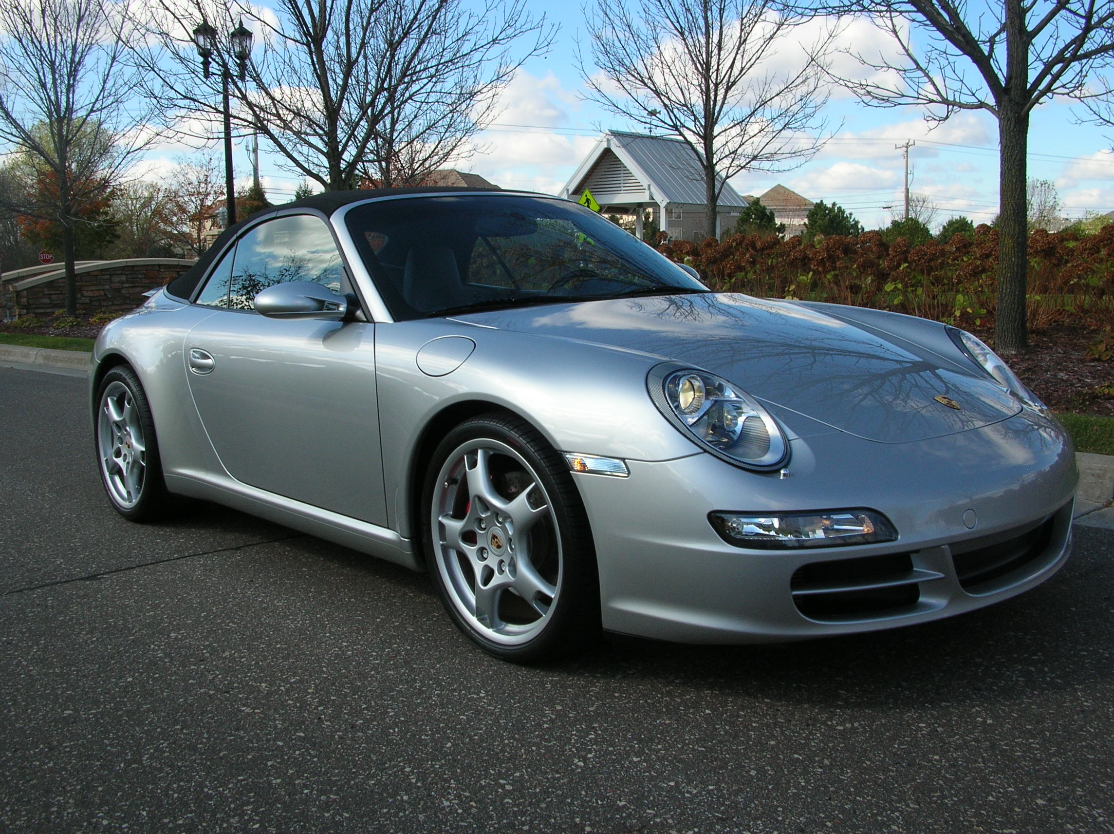

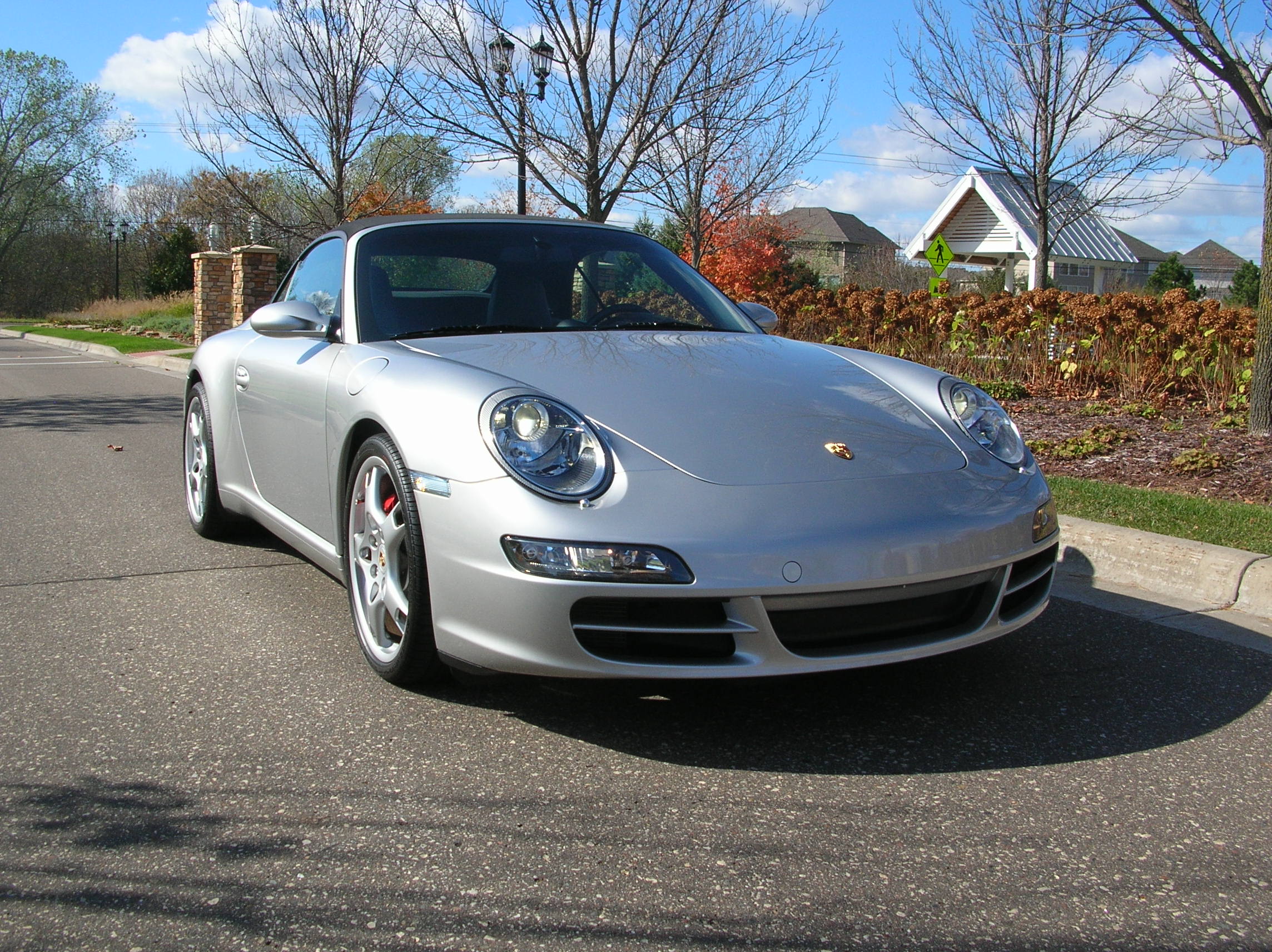

If you are still looking...
I have the set of 7mm fronts and 14mm rears with the long bolts (Suncoast). I had them on my 997.1 S and they were awesome with the lobster forks! Let me know If you want them…here are photos of the car with the spacer set (before I put on HRE P40s).
