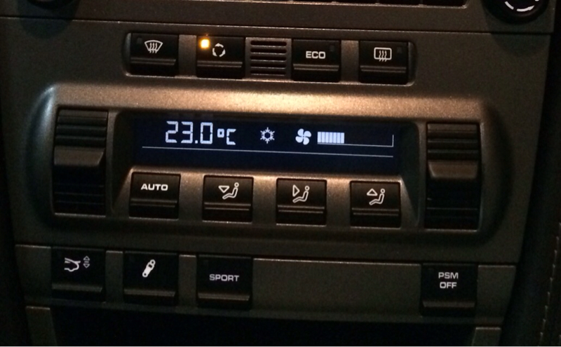

Brought car to Porsche Scottsdale today for an oil change and asked about repairing the crappy look of my fan and temp buttons. To my surprise they have a contractor who comes in to do this. He uses a template and repaints then seals them. Looks like brand new, couldn't be happier. BTW - best dealer hands down, 7 star service all the time!

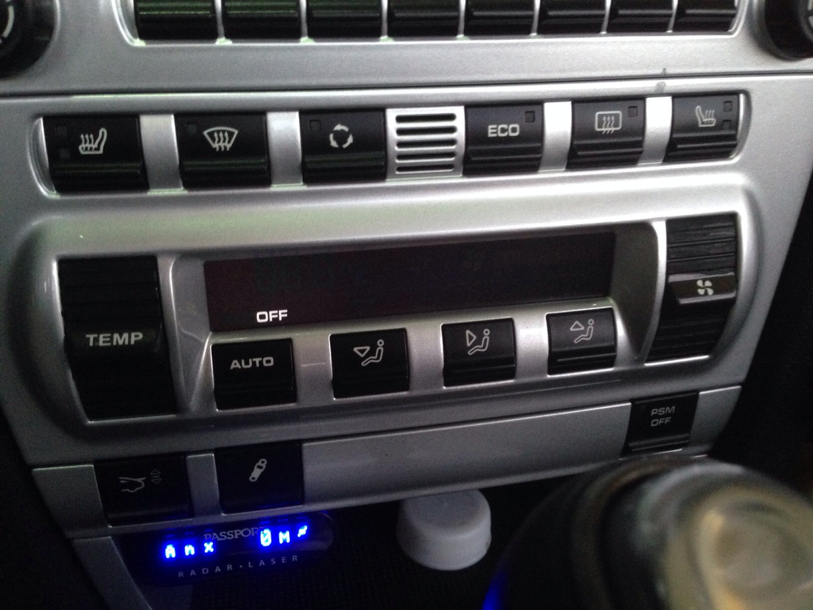

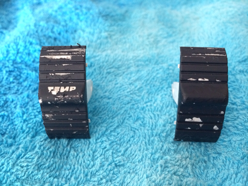

I recently fixed it myself as I couldn't stand the peeling rocker switches....
Before...

After...
I'm very happy with the result. Even though I knew I couldn't redo the "Temp" and Fan icon, it was still way better than the peeling looking. I'm very happy with the result.

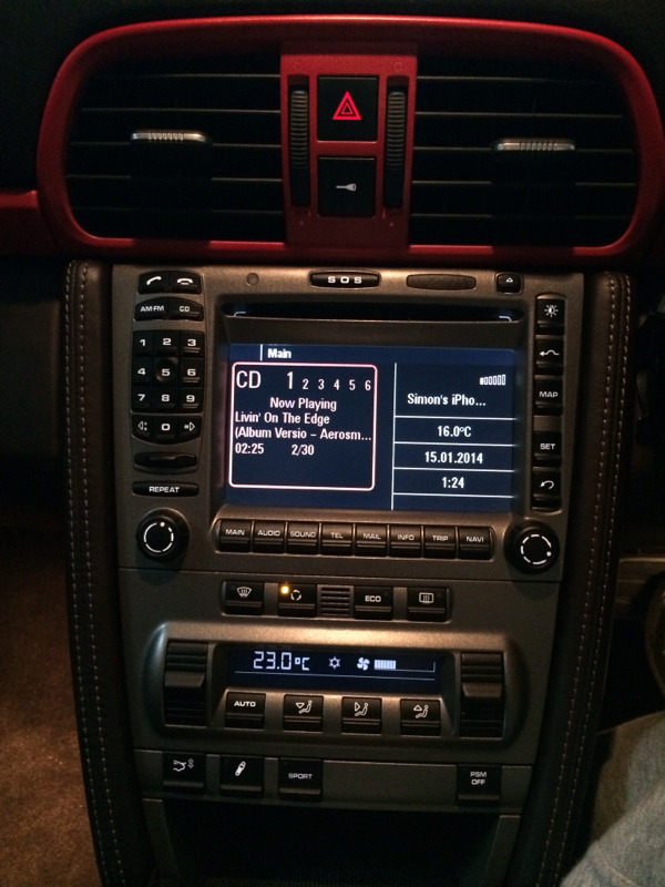

Here's the info that I followed.
My only other advices are:
1) when removing the board from the faceplate (pic 2), take note on how it is assembled. Other wise you might not put them back together correctly if you have not dealt with a LCD display before
2) I didn't need to use a knife to scrape off the rubber coating. Just rub hard with alcohol and micro fibre cloth
3) take note of the left & right switch. they don't look very obvious which side they are, I put the first one on the wrong side and nearly damaged the switch.
Good luck
