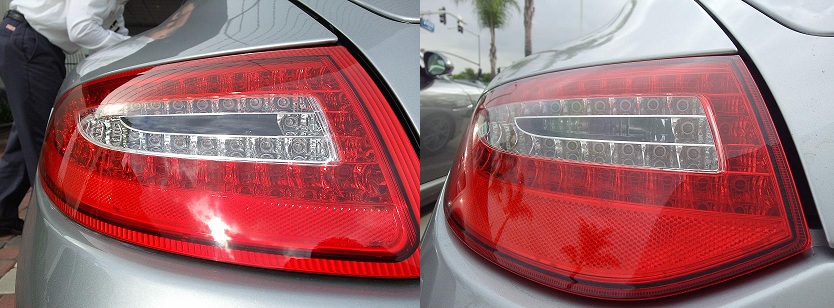

Hey guys,
If I wanted to facelift the rear of my MKI 2005 C2S to a MKII look with the new shape tail lights and rear bumper, what parts to do I need to make it work, is there anything I need to consider besides the parts?

I have pretty much the same car as yours and besides for the bumper, all I needed was both lights, a factory module that goes under the drivers seat and coding. I did not have to change any harness or run an aftermarket harness. If you do a search here, you should be able to find all the part numbers you need.

I personally dont like the appearance of the aftermarket LED for 997.1 compared to the look of the OEM 997.2 LED. You can also have a good body shop mod your original bumper to fit 997.2 lights, or you can sell off your stock parts to get some of your money back.

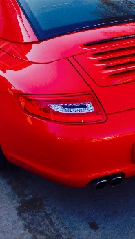

I'm the opposite. My biggest problem with the .2 is the taillights. I like the LED part, but the oversized droopy bottom that doesn't illuminate turns me off. It's almost as bad as the 996 fried egg. I think the .1 with aftermarket rear LEDs look best, but I haven't done it personally since it seems reliability has been an issue with some of the vendors. To each his own.
I Agree, I guess it all depends on how much you invest on the LED's if you get cheap ones the look may not be so much as OEM, I installed mine with no code errors and it lifted the look of my car sooo much, best mod I've made

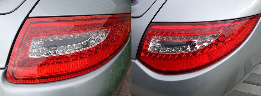

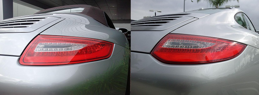

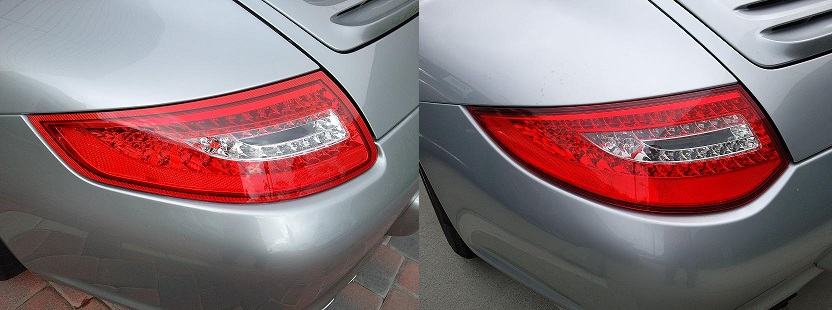

I had the original Dectane led lights, because they resembled the oem lights.
However, I sold them since I didn't like the way it lit up when braking.
