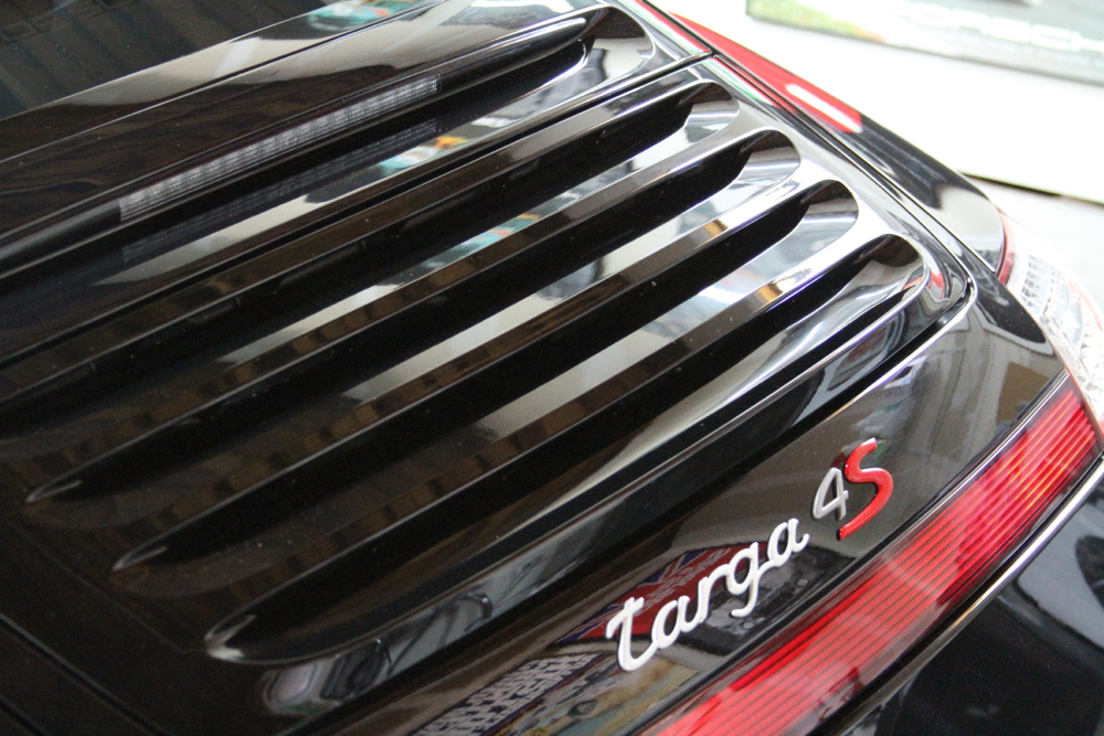

I do - plenty actually. Worth a try. Thanks Eric.
Oh, and BTW, I'm continuing to love the red "S" sourced from you.
