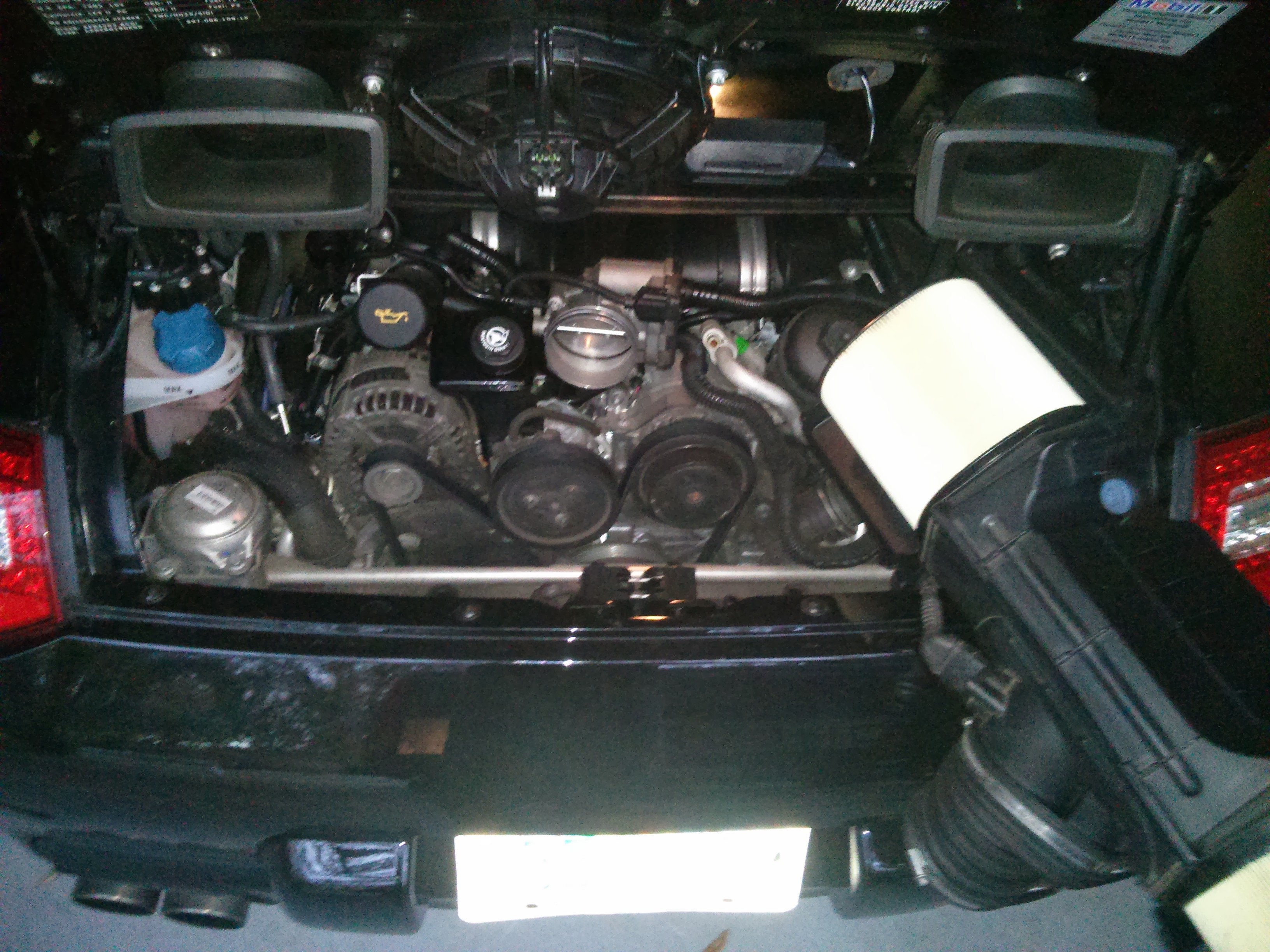

I had some huge throttle body issues on my 2010 C4S and I cleaned and ended up having to replace it recently. There was a strange amount of play in it and it was idle hunting and lumpy all over the place. Anyway I had to remove the entire air box because the main hose going to it is so tight. Remove the 4 bolts and give it a good wipe down. Be gentle with the flap so you don't damage the servo. It was a bit of a pain to get the air hose clamped back on the TB. Easy to do just take your time.
