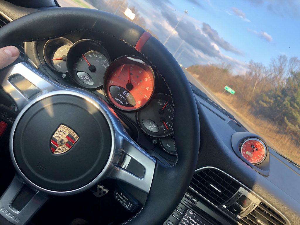

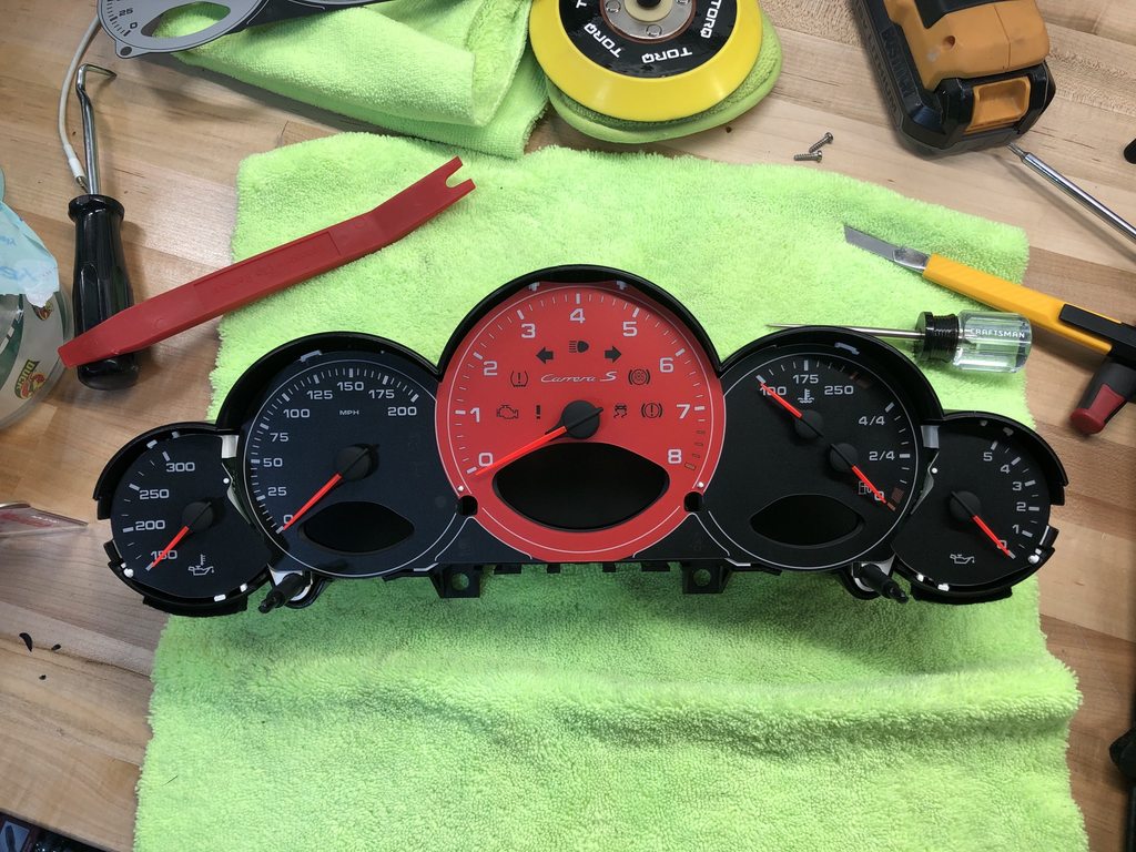

You can probably have a competent gauge shop do the repair and replace just the lcd from another working 997/987 cluster. The center display is the same and 987 Boxster/Cayman used clusted can be purchased for only a few hundred bucks unlike 997 units. Otherwise you would need a brand new cluster from Porsche which I believe will automatically update your correct mileage stored in the DME. Once the cluster hits 500 miles the odometer reading is burned into the cluster itself which renders used clusters useless for anything other then parts. I did the gauge face conversion on mine which was pretty nerve wrecking knowing the price of replacement in case I screw up.
