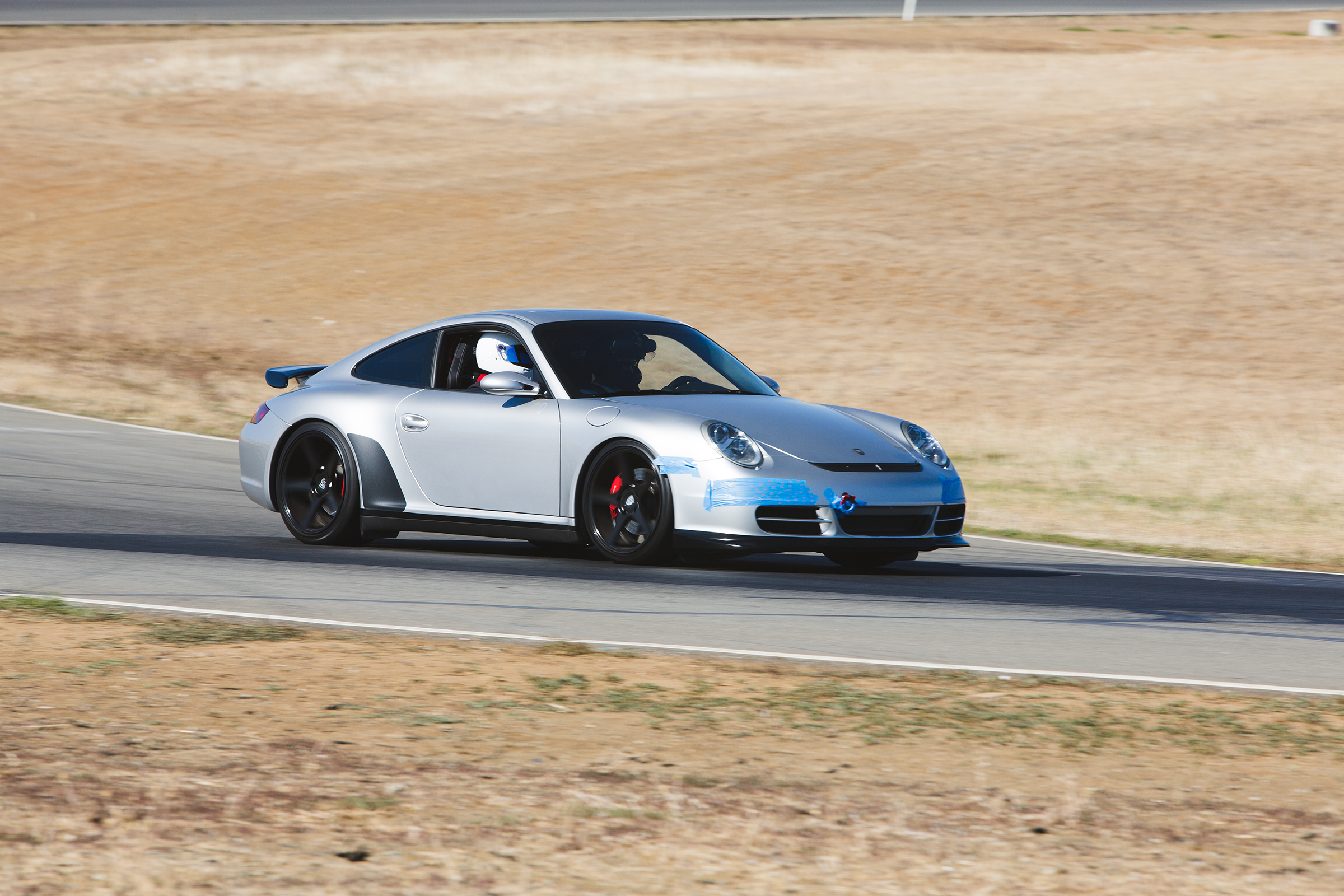

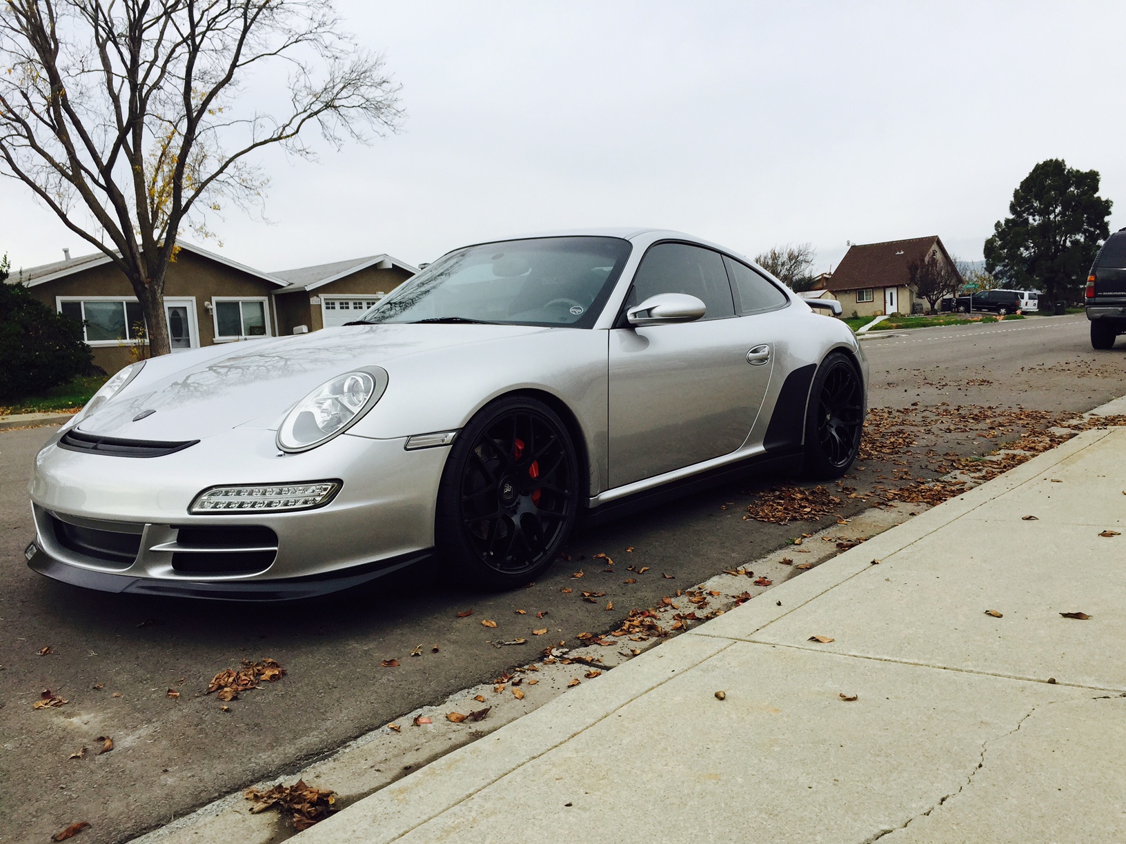

Just want to give a shout out to Sam at EVOMs for his customer service he provided me with the purchase of the Stage 4 flash for my 997.
I have a 06 4S 3.8L, with some mods to the motor. The mods are an IPD "competition" plenum, 82mm throttle body, Fab Speed headers, 200 cell cats, and air intake system.
After I installed these mods the car performed well, but less then what I had expected. After months of reading different flashes that 6speeders have done to their cars, I decided to go with EVOMS. I called Sam and explained to him what I was looking for, and he suggested the Stage 4 flash.
I uploaded it to the car yesterday, and took her for a test drive. Boy, was I surprised. The lag I felt from 2nd to 3rd gear and 3rd to 4th gear was gone. The car responded with a quickness that I had been looking for. Then I put the car into sport mode, and noticed a quicker response in those gears. I am very pleased with this flash they made for my car. So, again, a big thanks to Sam and EVOMS.
