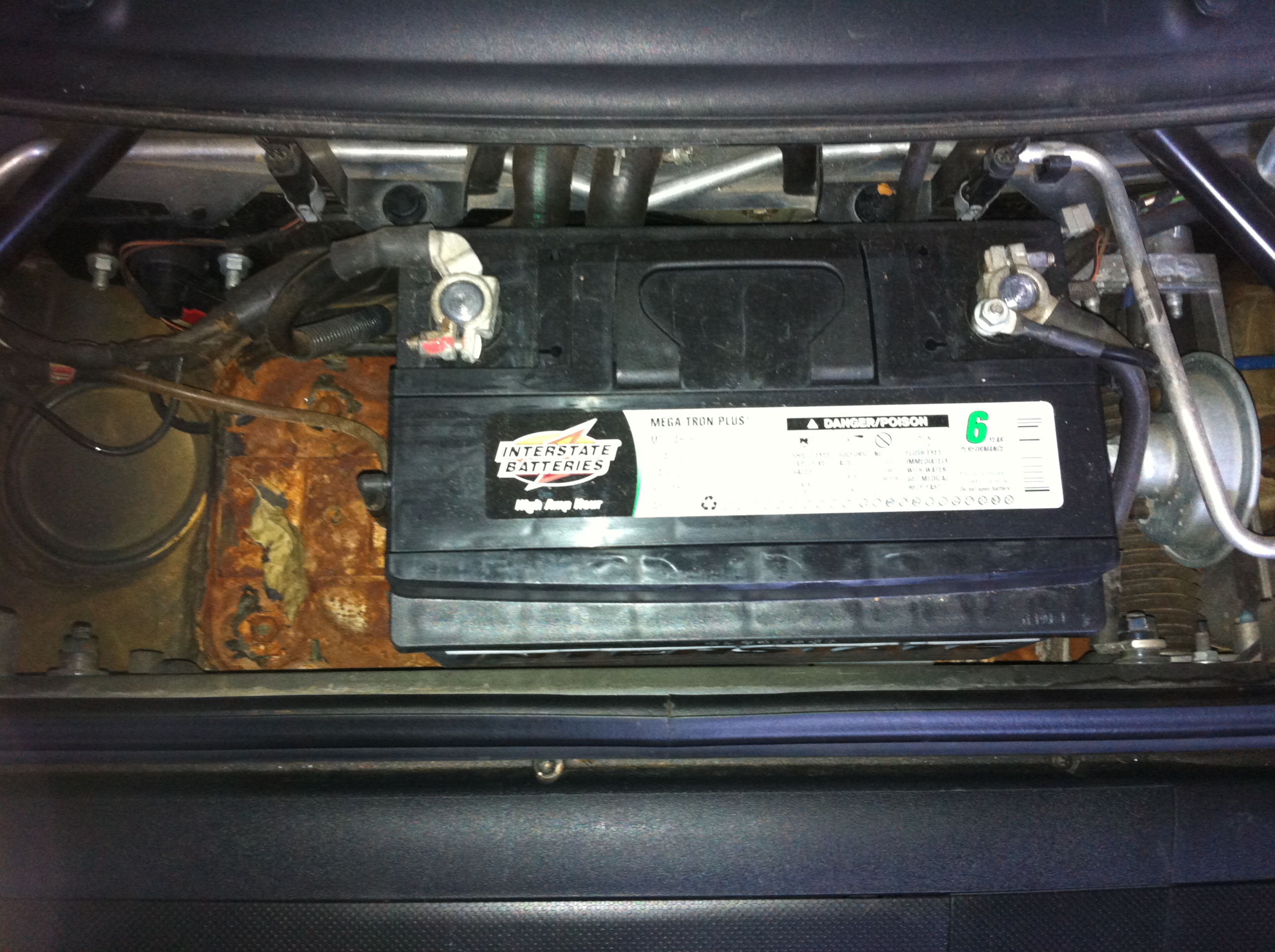

I took the car to Autozone & have them checked the battery. He said it was only 50% charged. I guess it sat too long in their showroom. should I get it recharged or just buy a new one. I don't know how old it is. IF it does the same thing with the new one, I could rule out the battery. Here's what it look like. Does it look too small for this car? There's about 3" left on the tray. The one I bought for my old 996 was much bigger than this.
Size looks right, there should be a clamp on the left that holds the bottom of the battery down. I'd charge it and go from there. Do you keep your car locked? These cars use more power in standby with the doors unlocked. So keep it locked, even in your garage. Also if you don't drive your car frequently a battery charger is recommended as even locked they can drain.
Picture is a little blurry, but more importantly what's up with the rusty battery tray? I'd fix that while you're in there. There's supposed to be a vent line also, but I can't tell if your is missing? Maybe that's why it got all rusty.
Edit, I see the vent line is there. Maybe it was off at one time and drained acid onto the tray.

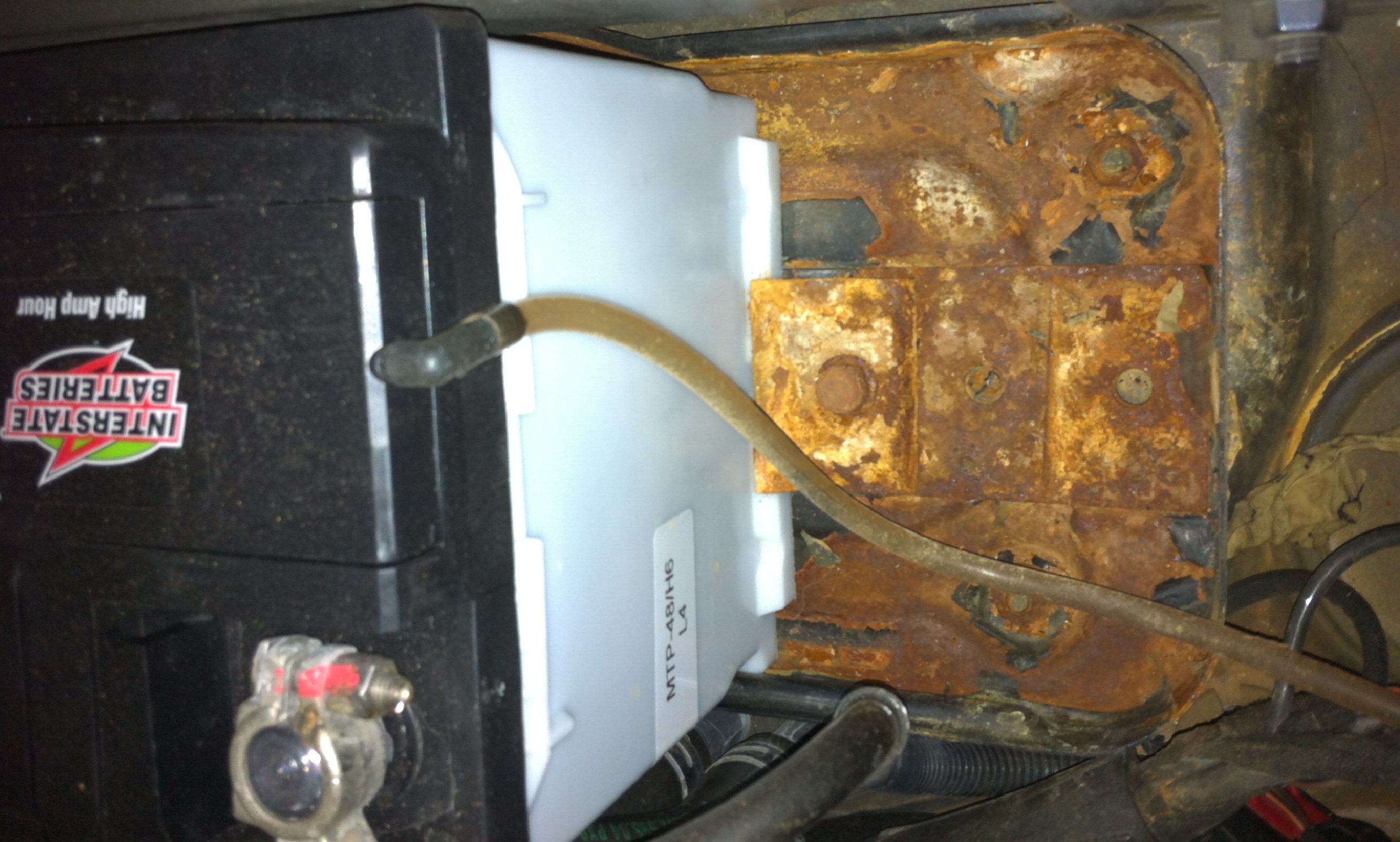

no, I never locked the doors when it's in the garage even on my old 996. Learned something new everyday bout the 997.
yeh it's the battery acid drained on the tray. I don't see any rust anywhere else. There's 2 more holes for the clamp bolt. I may go to a wider battery to fill up the gap. This one look like it belong on a civic.
You can go wider, but you'll need to do something about the nuts on the bottom as the wider location doesn't have them. The narrower location has tapped holes.

Most modern "maintenance-free" batteries no longer use a vent line or spew acid like that. I would ditch the battery just for doing that.
You also seem to misunderstand something about the battery. Your car's alternator should charge it back up to nearly 100% every time you drive any reasonable distance. If it is reading only 50% then either the battery is no longer capable of holding a proper charge or there is a problem with the alternator or the cable between the alternator and the battery.
Since it is clear to me you should ditch the battery for a quality modern one, that seems like the first course of action (as Pelican Parts recommends). While the battery is out, thoroughly cover any place you see that acid has touched/rusted with baking soda and gently rinse (try hard not to splash). You will see a lot of bubbling when it first gets wet as it reacts with the acid. Repeat several times until you see no more reaction from the soda (it doesn't bubble anymore). That will neutralize the remaining acid. Be sure to thoroughly rinse the bottom of the car as best you can. Also rinse any surface the washed-out solution touches since it will stain any surface it comes into contact with, especially concrete.
