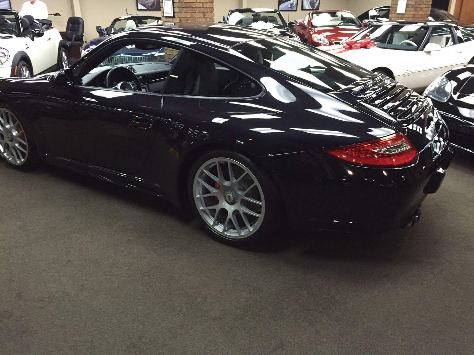

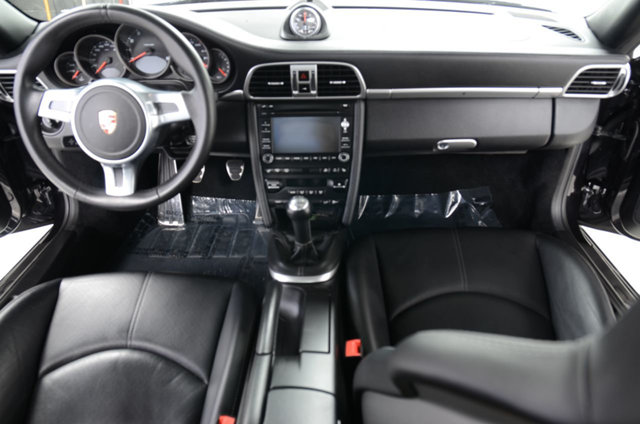

Hi, I just bought a 2012 911 GTS and Love It so much. I'm finding...the lack of integrated Navigation and data streaming (Pandora/mp3/.. through phone) into the stock PCM unit to be distracting. My car has Bluetooth but apparently, only for calls. The center storage console does have the physical USB, AUX, IPHONE, connections. Of these, only IPHONE shows up via PCM source button menu. I believe the following to be the reason.. since my car also has a two disk CD player, located above glove compartment, probably the CD is connected to the PCM AUX input and is identified by the PCM showing up as "CD" (one of the four sources displayed am,fm,iphone,cd) instead/in replace of AUX. I speculate, I'd have to physically remove or disconnect the cd player form the PCM to register AUX on the screen. But I could be wrong. Does anybody know for sure? Even if I tried that and it worked, using a wired AUX is not an ideal solution.
Another question I'm wondering about is why there is no USB displayed as a possible source?? What is the physical USB port for? In case anyone is wondering, I don't have an iPhone.
I feel that the lack of Nav keeps one hand away from wheel too much, especially painful with a manual transmission. Looking at my "small" Samsung Note4 display for Nav is more distracting than if Nav showed up on the center console display. Just today, I got a dash mount for the phone which will help in that regards somewhat, but I still would like a the Nav integrated with radio/phone...so it will all go through the car's BOSE speakers and I'd be able to hear Nav over the radio/phone call if all three audio were active... I'd also love a rear backup and if possible forward parking camera integrated. I'm not keen on the aftermarket solution that comes with anther rearview mirror with integrated display for the camera video.
This car came pure and Stock which i appreciated when buying. I know..extensive modification's probably Will depreciate the value. But if done tastefully, professionally, and with added function/value, do you think potential future buyers would mind?
Any suggestions, either for a solution or one deploring the thought of aftermarket modification, would be Greatly appreciated. Looking for quality, a fully integrated solution that will not break my already dented bank account too much. Also, one that would keep depreciation at a minimum?
This beautiful car is one of the purest, most tastefully optioned incarnations of the 997.2 911 variants. 6mt, lsd, full leather, gts, rwd, coupe, beautiful silver rims,... I want to honour that purity by keeping any changes minimist in nature especially without altering the drive. In the end, i may decide not to touch it. Interestingly, I think in this case, modern integrated techology could help me enjoy the purity of the car more by minimizing distractions from the drive. Integrated Nav and data streaming will actually enable one to enjoy the car''s driving dynamics better. A backup/front camera would help prevent a heart breaking mistake.
I posted some pictures for reference and your enjoyment.
Thank You All in advance for any guidance, advice, suggestions..

Just to follow up on the solutions I found/realized.
- no aux/USB in source menu (despite and assuming your car has the aux,usb,ipod inputs in center console) This happens for me since i had a CD player. To fix, first put any CD into CD player and select CD from source. This will enable you to go to options under CD.. then ENABLE usb &aux. Now, when you hit source button, you'll see aux and usb. (This is not obvious, not in user manual, nowhere to be found on the internet...until now)
- pcm 3.0 with phone bluetooth can't handle streaming data. So, can't use smart phone's nav and music through Internet or mp3 to your Bose speakers --> Solution is simple after doing above to enable aux. Next, buy a small $29 bluetooth to aux converter device With internal lithium ion battery (found in Best Buy) and a small mobile chargable battery. You want to have a unit with a built in internal battery since this will be the quietest offering the clearest audio to your speakers. If you try to plug into car charger or the usb for power, youll get alot of feedthrough noise to your speakers...not good. When you rely on the device's internal battery, you'll get clean audio transfer. Meanwhile charge up a second mobile battery through usb or car charger which can be used later to.. (after this mobile battery charger is fully charged, disconnect it from the car's cigarette lighter or usb power source first..) simultaneously charge and use the bluetooth to aux device when its own internal battery is low. Your smart phone links to car's bluetooth for phone calls, AND to the bluetooth to aux device located in center console. Now, you can make,receive phone calls AND stream data music / navigation instructions , through your cars audio you'll need a phone suction cup holder to secure phone on top of front dash. Use charger port on left of passenger side foot well.
- rearview camera --> no acceptable solution found yet
I found the above to be an acceptable solution as it doesn't involve after market modifications and leverages the car's and your smart phone's capabilities to their fullest. (I have Samsung Note4 with unlimited data plan) I typically use Google maps/yelp for navigation..
Next I'd like a wireless backup camera to send video to cell phone when in reverse. Have seen a couple that might do trick.. updates soon.
