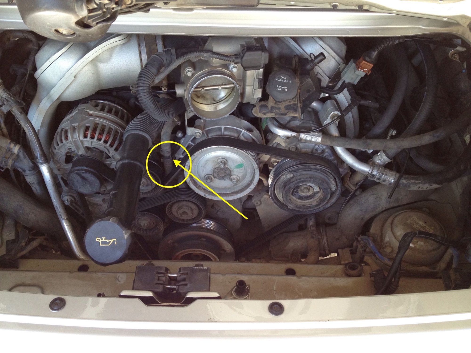

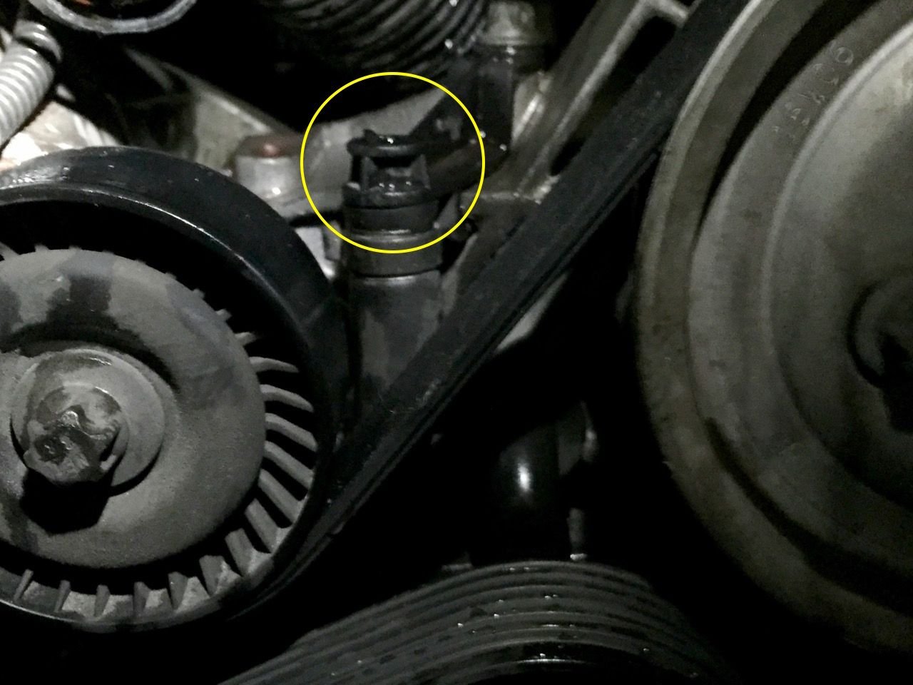

Hi all,
While attempting to replace the AOS, I broke the one of the pipes / joints when disconnecting it. Can some one help me identify this part?
Thanks in advance.

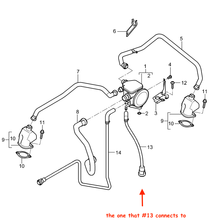

Do you want the connector itself?
It is pre-assembled to the line supposedly, I don't think it is sold separately.

Someone from the other forum provided the info. Apparently is a part that is commonly got broken. So reposting it here in case someone needs it.
https://www.ecstuning.com/ES1483187/

I broke mine when filling up the oil and got stuck in the middle of nowhere. i replaced it with a anodized aluminum one this time
http://www.rmeuropean.com/Products/9...G157-V944.aspx
but the porsche replacement Part Number: 99610622652
