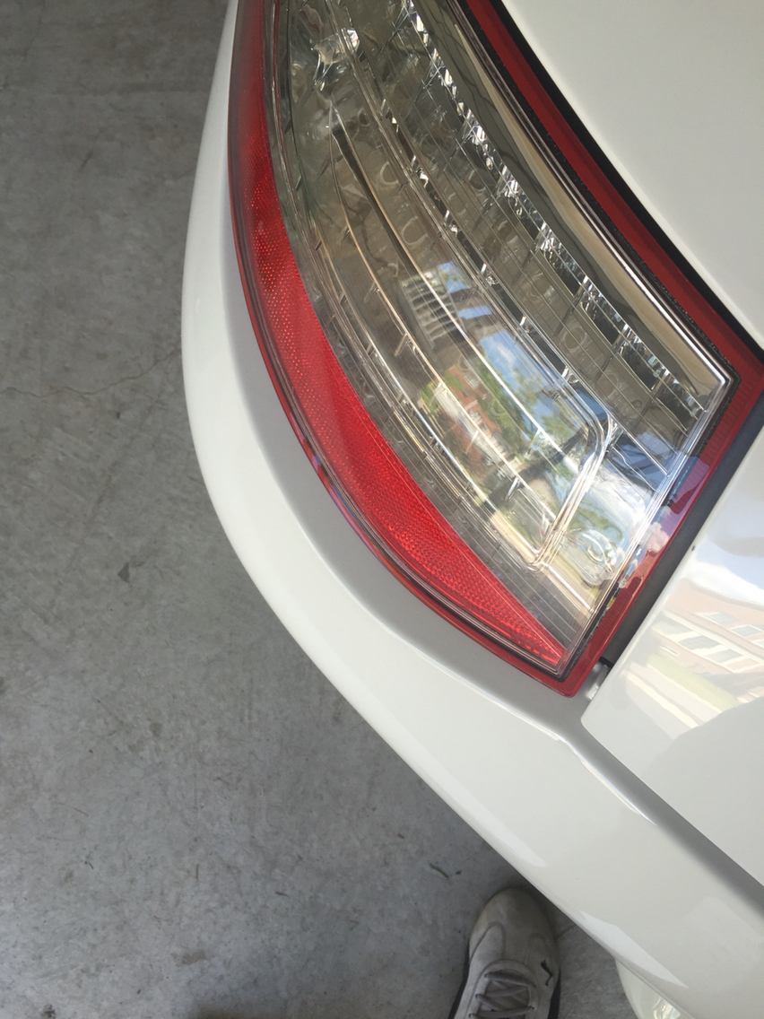

Looking for help from anyone that has successfully done a 997.2 REAR conversion. I'm having some bumper (OEM) fitment issues and am wondering if I missed a step somewhere. I can't get the bumper flush to the bottom of my LED lights. The screw mounting holes throughout all line up though.
Thanks !

I don't think they are supposed to be flush with the bumper.
What ^ said. That looks just like my Turbo.

Jason's write up is amazing. I didn't even bother buying a new bumper bracket. There are two holes that don't line up (hole #2,3) and I just had my shop drill through the oem 997.1 bracket. The bumper ain't moving.
The 997.2 LED lights will need to be shaved down a bit on the plug port to allow the harness plug side to slip over. Takes like 2 seconds to figure it out.
Best 'mod' ever. I highly recommend it. It's like night and day !
