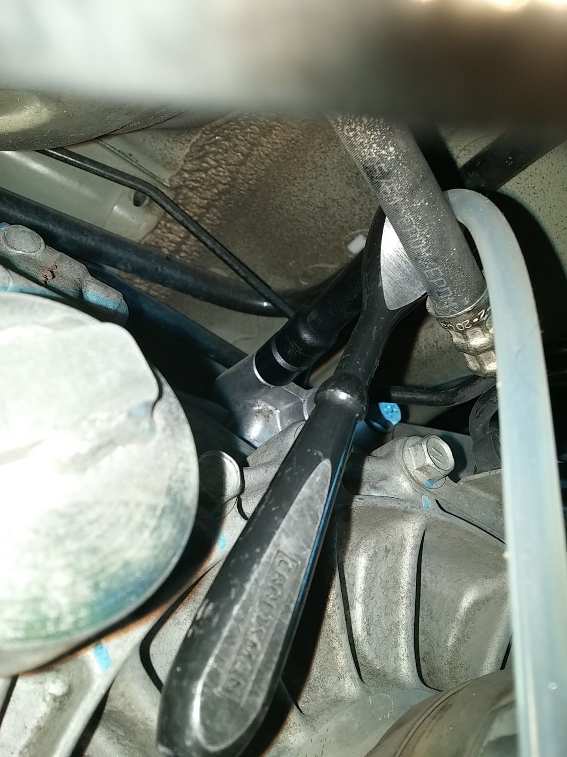

I don't normally do that. I only did it when I had introduced air into the system because after doing a lot of normal bleeding at all 4 wheels, I still didn't have a solid pedal that would hold pressure well. After activating the solenoids during the bleeding process, everything returned to the proper feel.
If I happen to be doing the bleeding on the lift becuase the car is up there for another reason (oil change, tire rotation, etc) I'll also bleed the clutch at the same time since it shares the same brake fluid supply and I'm not sure if fluid gets parked there or moved through the system when the calipers are bled. I came up with a really neat bleeding setup using stuff I already had. One of my ratchet sets is a Craftsman (other brands available too) designed for long bolts so all of the gearing is outside and the sockets, extensions, and ratchet handles are open down the center. This lets me slide the silicone bleeder hose with bleeder bag attached through the center of the ratchet and then I can loosen and retighten the bleed nipple without having to remove the tool from the nipple as that one is kind of a PITA to access. No drips of brake fluid anywhere and no air entering back into the system. This one is a two person job though as the clutch pedal has to be pumped slowly when the bleed nipple is opened and then the bleed nipple closed before the pedal is allowed to return. Setup looks like this.
Clutch Bleeding Rig
Hose on bleed nipple then ratchet setup slipped onto bleed nipple base
Fluid coming through the line
