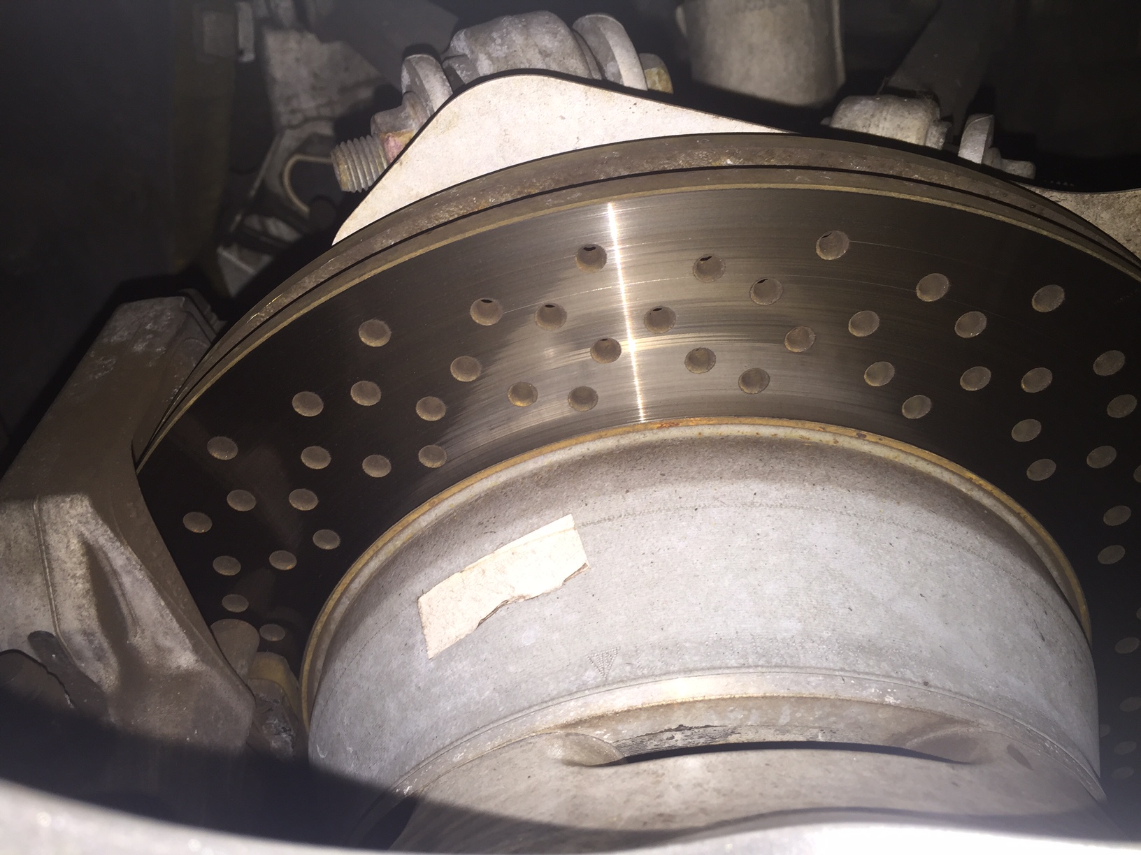

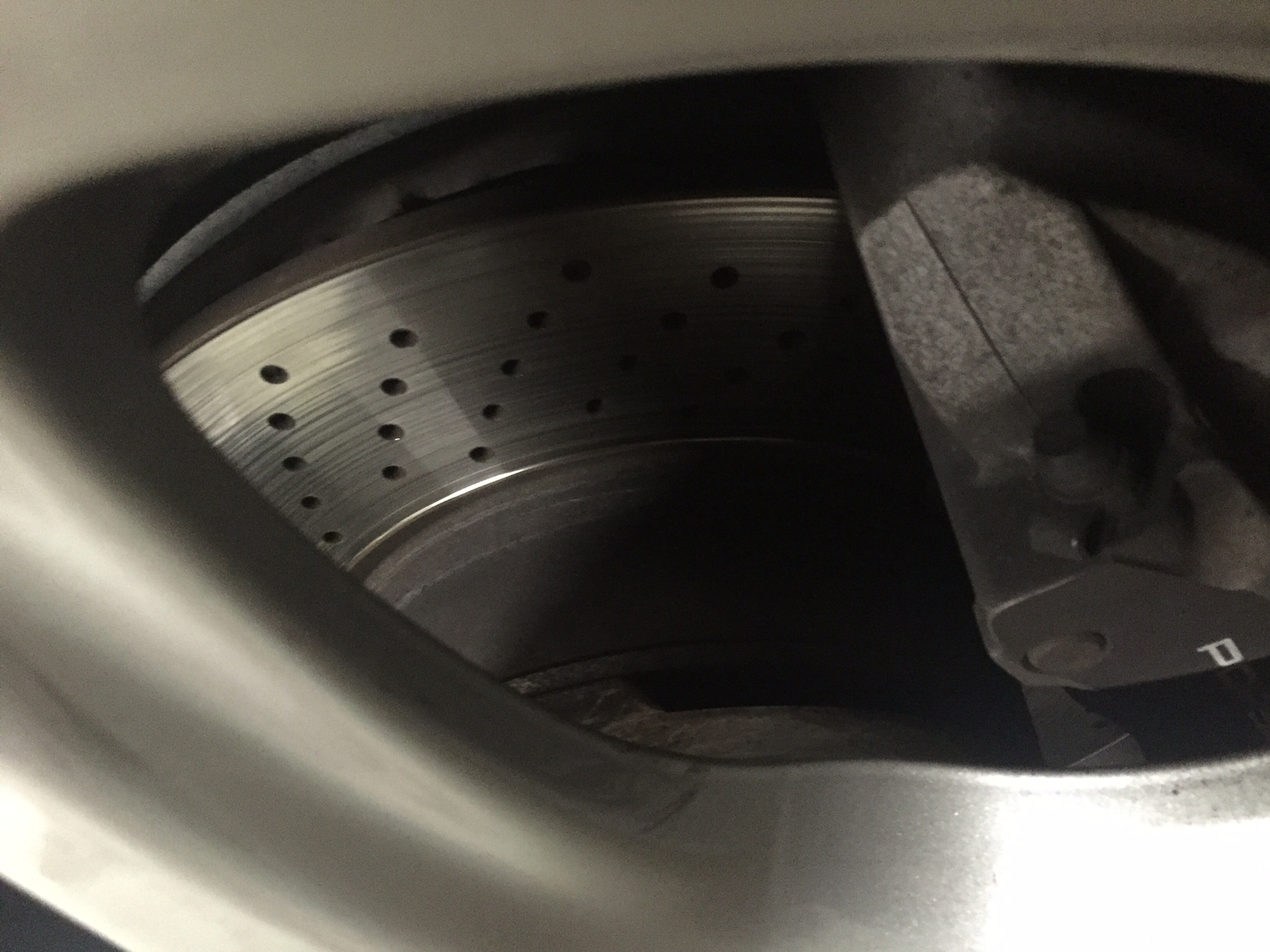

I'm considering replacing the OEM lug nuts with titanium and I need to know if I have spacers. I think I recall being told the car had 5mm spacers on the rear, but I'm not positive. Short of taking the car to a shop and having a lug removed and measured is there a way to determine if I have spacers. I think the data sheet under the hood (photo attached) has a lot of information, but I'm not sure if that information is there. Any help would be appreciated.

Post a pic from behind the wheel. You should easily be able to identify a spacer.

All you need to do is look between the spokes at the hub - you'll be able to see if there is a spacer. Don't need to remove anything. Post a picture and we can tell.
BTW - option code XRP is for 5mm spacers so if they haven't been removed you do have spacers based on your build sticker. The option would be for 5mm spacers on all 4 wheels.

Thanks...I've attached photos. I hate to spend the money to order lug nuts only to find they don't fit.

Yes = picture shows a spacer.

5mm variety most common for OEM.

My eyeballs say 5mm spacers as well. As far as to which bolts to get, look at my post here: http://rennlist.com/forums/997-forum...olts-5.html#73

+1 on the World Motorsports ones. I have a set of their closed end nuts on my studded RUF car and a set of their bolts on my Cayenne. You may want to verify of those spacers have a hub-centric flange on them to keep the wheel centered at high speed. Some people say they're not needed at only 5mm but the right way to do it is with hub centric spacers. If yours aren't, Adaptec Speedware is one of the only companies that makes hub-centric spacers in the narrower widths, like 5mm and 7mm. If you know what you're looking for, you can tell whether the spacers are hub-centric by removing the wheel cspbsnd looking at how the hub, spacer, and wheel are mated together, or do that and post another pic inside the bore of the wheel, and we can tell you.
